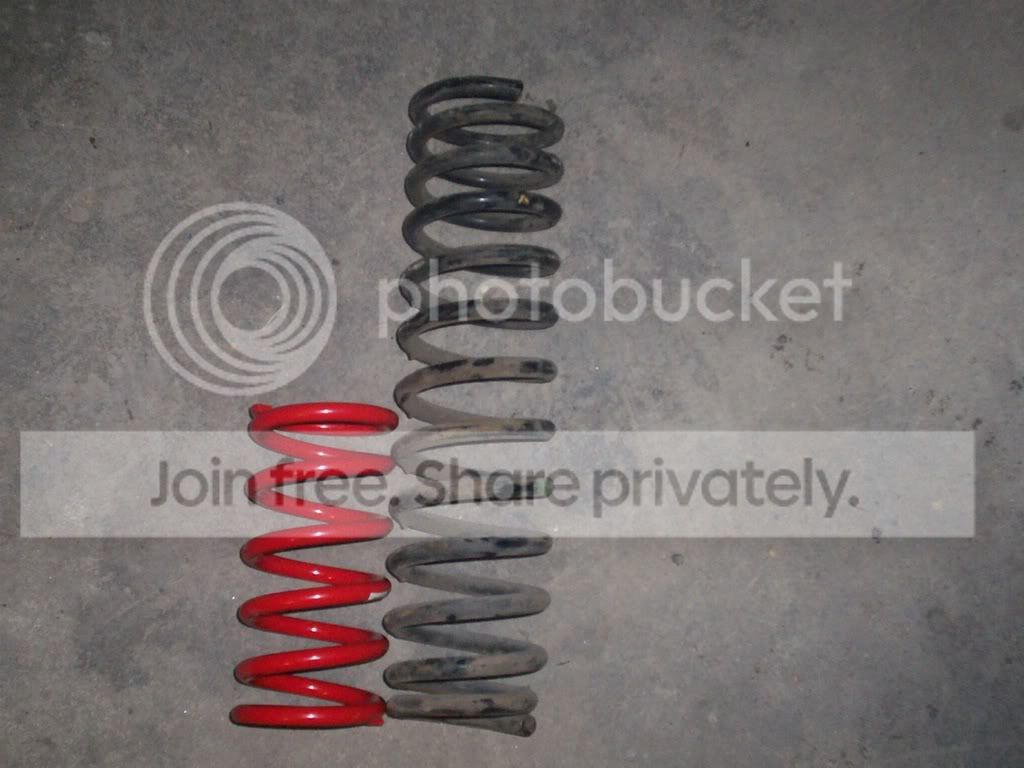

Yes so me and my friend were trying to put on new matrix coilvers on my 93 integra ls with stock shocks. Now i kno matrix isnt best but just wanted put some new stuff till get money for better . But anyways we put togther and isnt workin we think maybe recieved wrong order or something the springs i got are almost 2 times smaller then stock spring.
and was told by somonelse they thing wrong order because way to small need other opions
plz help take all advice
thank you

no i have the other parts i just wanted to kno if the spring looked really short i will post pics of whole thing together tonight.But when put togther the spring wansnt even close to being tight u could move up and down with your hand and this is with weight of car on it

How tall is the spring?
I picked up stiffer springs for my GC's and I went with 7"f and 8"r i think or vise versa. Depending on the ride height and/or shortened shocks, i have seen 6" springs before and possibly 5".

This is what shocks look like with OEM-style springs on them (stock or regular lowering springs). You can see the spring perch way down near the brake line bracket.
Now this is what they look like with coilovers. You can see how the spring perch is much higher up on the shock:

What is not working? That length looks right.

im tryin do my best to explain will take pics tonight of what looks like to give better idea but since the spring is so much shorter once we put on shock and put the suspension back togther the spring wasnt even close to being tight with weight of car on it like u could grab the spring and move all around with your hand

When you assemble the shocks and coilover sleeves, the spring will be loose. However that's only when the suspension is fully extended (either off the car, or suspension at full droop). Once you put the car on the ground, the springs will compress.
If they still don't compress even with the car on the ground, then the car is totally on the bumpstops, which pretty much makes the springs useless, and in fact will make the car pretty dangerous to drive.
