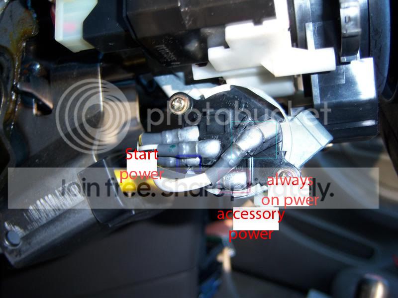

trying to wire up my turbo timer and i ran into some issues. first off i have a 96 ls integra i have a greddy turbo timer but when i ran the wires i have found all the spots that i needed for the wires to be ran to but i found some sort of a aftermarket alarm system that will not let my car start without it in there but should i wire it up to that or? any help would be awsome!!! here are some pictures that should help with the problem

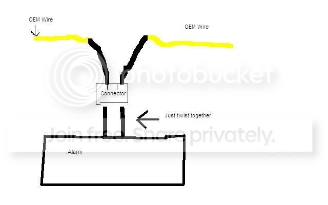

Those 2 black wires coming out of the alarm should be hooked to the ignition after the white connector. Usually you just cut the oem ignition wire in half and run one of those black wires to each side (to install the kill switch), so if you connect those 2 black wires it should be ok and start fine with the alarm taken out.
