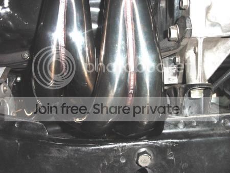

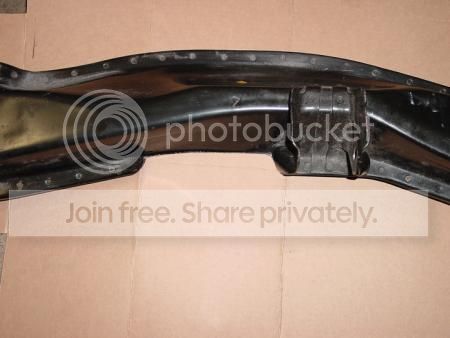

The crossmember is the black metal piece that you will see running under your front bumper and radiator. It is in these pictures, that I got off of g2guru on http://www.g2ic.com. You can search on there about notching the crossmember and find more info. Anyway, here are the pics, he is using a Jun header in these:
If you go on g2ic.com and search under g2guru, you can click on his homepage, which links you to his imagestation account, and has a lot more pics of the crossmember install and his header.
As for the o2 sensor, the Mugen header has an o2 sensor in the collector, just like the LS. The one problem besides the xmember fitting and needing to either remove or move around the rad hoses, rad, and fan when installing, is that the Mugen collector is probably bigger than a stock cat flange, so you may need to investigate and get a larger diameter flange welded onto the stock cat, or get a high flow one made. I am pretty sure the Mugen collector is 2.5", as opposed to the 2 inch one for USDM headers and the cat, so you will need somebody to make a new flange on a high flow cat to get the best gains. Contact Dave at SMSP on this board, he does it all the time.
