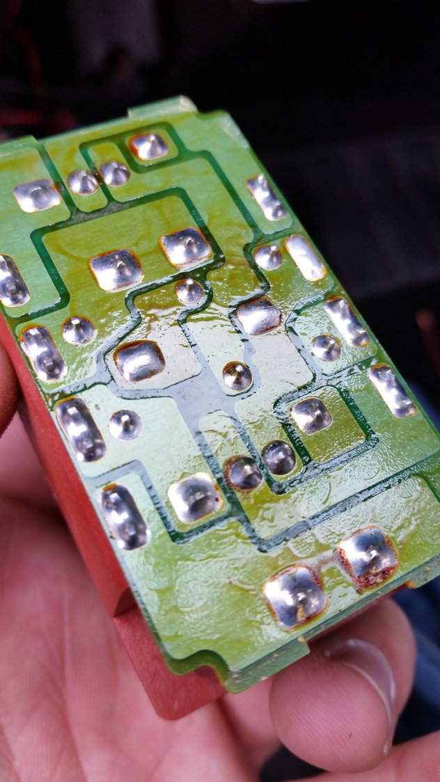

Hi guys first time poster, ive looked near everywhere to figure out why my integra doesnt want to start. The main relay buzzes when im about to crank, i hear the fuel pump send gas to the engine so fuel pump relay is good. I read that if the main relay buzzes three time its good but i just hear it continuously. I bought the car in march and hasnt given me problems since. Its a 96 rs integra with a obd1 conversion. Any help is appreciated

This is how my relay looks, is it usable?

Main Relay Fix, Troubleshooting (Honda, Acura) and how to solder

Alright ill give this a try! Thanks
