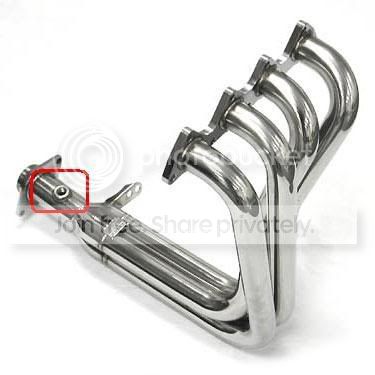

hey, i have a 1995 integra with a ls/vtec 93 ls block, 95 gsr head, I ordered a set of headers for a 94-01 gsr and they didnt fit the were to long on the bottom (see pic), did i just get sent the wrong header, or am I not supposed to order them for a gsr.
the picture is the exact header that i have, what boxed in is how much long it is than the OEM header.

you should have got the one for whatever model car you have

I think the stock exhaust manifold and secondary pipe on the grs is longer than on the ls/rs. I think you should have bought the header for the b18a/b. Someone second this.

What kind of exhaust and cat do you have? What kind of header did you order? The '94-'99 GS-R uses a different header than the '00-'01, so there is no such thing as a '94-'01 GS-R header.

the exhaust and cat are stock, 95 gsr, the cat has the o2 sensor in it, As for the header I ordered it from ebay which is dumb but cheap and the title says 94-01 gsr header, but like 99% of the headers say 94-01, even the $900 JUN header says 94-01,
so do I find one for 94-99 or am I supposed to use a b18a/b as stated by someone else

You need a header for a '94-'99 GS-R.

agreed...or you could go to a muffler shop and have them hack off the current flange, draw it back, and re-weld the flange to accomodate for the header you purchased

yeah..not doing that but if I'm supposed to get one for a 94-99 gsr then why is every header advertised as 94-01, not just on eBay but even on websites like passwordjdm, and even on DCsports.com. I'm not arguing the fact that, that is what I have to do but it doesnt make sense why would they advertise for 94-01 if only 94-99 fits ....DoEsNt MaKe SeNsE!
