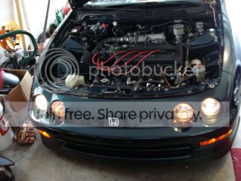

so I just took my HIDS out and put in normal silverstar bulbs, but now Im not sure whats going on......
when my normal lowbeams are on, the drivers side is very dull and both of the highbeams are also very dull.....like so

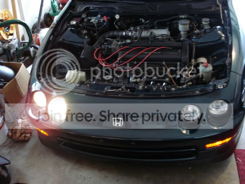

Then i turn my Highbeams on and just the passenger side highbeam comes on......like so
Im not sure what is wrong, maybe a fuse or something? anybody have some input?

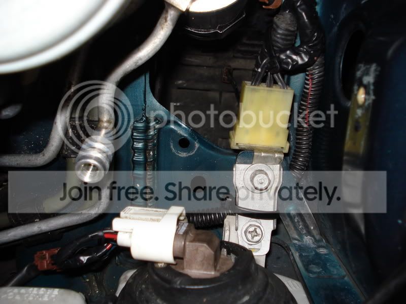

whats that yellow box right behind the lowbeam connector? does that need to be bolted to the body? cuz i have it tucked behind some wires......
all my grounds loook fine..... i hate electrical ****

We learn something new everyday...the yellow box is a ground, I never knew that. so now theyre back in order.
i put it on the headlight bolt, its a little better then up on the side.
