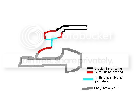

Hey, im new to this forum and i currently own a 92 Intgera GS and I currently bought a cheap intake from ebay. My question is, on the intake pipe there are two holes for rubber hoses, but on the stock intake pipe, there are three hoses... how do i fix this problem? did i get the wrong one? everything else seems fine. Also, is there site with directions u guys can direct me to? thanks.
Old Apr 5, 2006 | 04:49 PM
85mm LS VTEC's Avatar
Posts: 606
From: North America
Default Re: intake install question (tanklee)
Just go to your local parts store and buy a T-fitting.

here is my mad jdm tyte illustration to help you if you dont understand

wow...that pic actually helped a lot! thanks guys!
