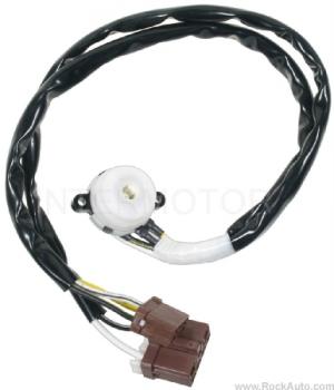

I've gotten a lot of help searching these forums over the past few years but have been unable to find a response to this situation.
A couple of days ago I randomly started having an issue where I would start the car it would start and die as soon as I let go of the key. After researching, it became obvious it was an ignition switch issue so I opted to try to open mine up and clean out the contact points. While I had it opened I touched the two sides together to start the car (just to get an understanding of how the mechanism worked). Anyways after doing so, I noticed a little bit later touching the 2 sides no longer had no effect on the car (starting or moving into the II position). I went ahead and bought a new ignition switch swapped it in and it won't do anything when I turn it (manually at this point with a screwdriver). So far I have checked both of the ignition fuses in the fuse box by the kick panel. What should I be looking into tomorrow? I'm guessing I might have blown a fuse somewhere or shorted something out but I'm at a complete loss of how to go about and find where the issue may be. Thanks in advance for the help.

So first thing to do is test for power on the white lead of the ign. switch harness, [ign. switch power lead].
If no power, check fuse 39 - 50A, in engine bay fuse box, if good check where ign. switch harness plugs in and confirm the white lead is lined up, [in ign. harnes plug] with the white in the dash harness plug, test for power on the white at the dash harness plug.
If you have power on the white, turn the ign. on to the run position and test for power on the black/yellow, [ign. power lead] and the yellow lead, [acc. power lead].
Let me know what you find. 94

Not sure what you mean about the big and small plug, do you mean the plugs on the end of the ign. switch harness...
Name:  ign. switch.jpg
Run = position just before start, [engine can run] so II, if III is cranking to start.
Again I'm not sure what your asking, waht you need to do is test for power on the white lead, in lower of the two plugs in pic.
If there is no power on the white lead, check the terminal the white lead is plugged into, unplug the ign. switch harness plug that has the white lead, test the pin the white lead would be plugged into.
You do not need to buy a fuse to confirm you have a bad fuse, use a 12V test light touch test light probe to each end of the fuse, one end will always have power, [even if fuse is blown] if both ends have power the fuse is good, if not, the fuse is bad, it's that simple.
There is not much point in doing anything untill you confirm that the white lead in ign. switch harness has power, if it does have power you can check the other leads in the ign. switch harness. 94

The contacts in your ignition switch have been worn down. Mine was doing the exact same thing when I purchased the car. An easy and free fix is to take the steering column lower plastic off, and remove the back of the ignition switch(2 small screws).
Once to are able to pull the ignition piece away from the actual key tumbler(this part)
The white plastic cap can be un-clipped, gently remove this part and clean the contacts, then slightly bend the raised portions of the tumbler up(inside the white cap) to make better contact. Re-assemble, issue fixed.
