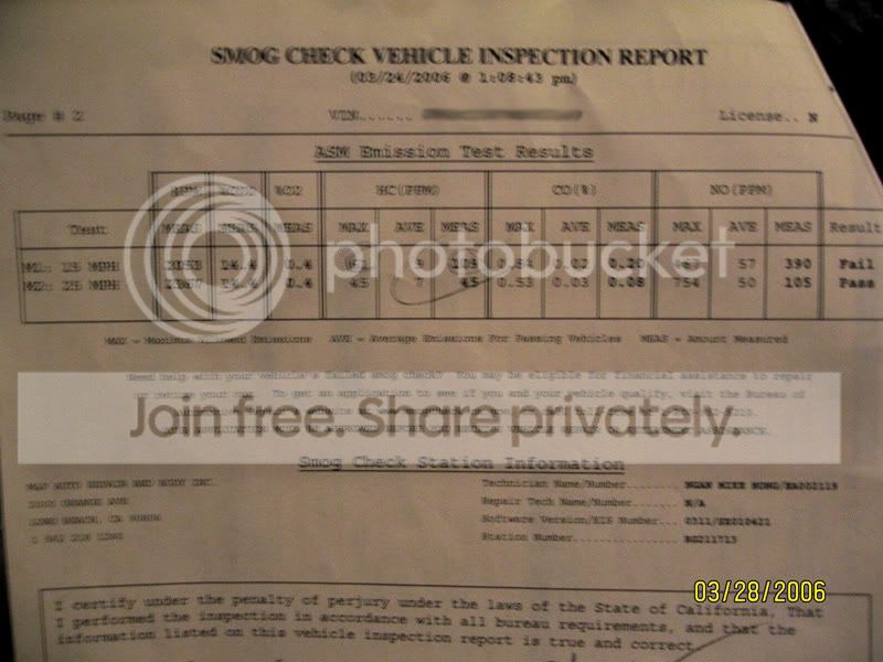

Aight i went in for a smog check on friday, and fail emission. I have a 98 Integra GSR. Now it says " This vehicle failed the MIL/Check engine light due to failure to sucessfully complete all OBD self Test"
When my Check engine light isn't on. (and no the bulb isnt pulled) Also i failed the HC(PPM) part of the test also. I had my Car running for a Good hour before i went to take the test.
result for the HC(ppm)
15mph.....MAX.....AVE.....MEAS
61...... 9...... 109 FAILED
25mph.....45...... 7...... 45 PASS
Now i talked to the tech that smog my car and he said it could be an exhaust leak. I have stock intake. stock header, and Apexi N1 exhaust. I was also Running 91 octane.
My question is Should i be running 87 while doing the test? Should i replace the O2 sensor for a new one? any help would be appreciated. thanks alot

check fuel pressure, cat condition, spark plugs and o2 sensors to see the ammount of carbon build up
i would check timing as well, ive failed a smog check before just because the distributor was advanced to 19 degrees

You're nearly double the max allowed... either you cat, o2, sensor(s) or all of the above. I don't know why you're not throwing any codes... have you had anything else done? The more information we have, the more we can help you.
on a side note, on my OBDI motor, when my cat & o2 sensor went bad, my car never threw any codes... but knowing that you have an o2 sensor before & after the cat, I thought it would be more sensitive...

well i bought the car and it had a check engine light for "P0420 Catalyst System Efficiency Below Threshold" Well i plug the obd2 scanner and erase the code, took a drive to see if it would come back. its been a good hundred miles and no code came back. Im thinking the Code is still stuck on the ECU?

The ecu does store codes. Just because you deleted the code from making the CEL come on does not mean that you fixed the problem. I would definitely check your cat and sensors.

what was your CO2?
do you have all the specs that the machine read out?

pictures of the result are up...bump cause i wanna pass smog
