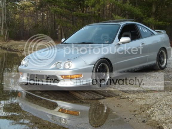

I have them on my 97Gs. I love the way they ride to a T. I called Andy and BodyKitsNW (A local HT Sponsor) and discussed with him what I did and didn't want it to ride like. He seemed to know his **** and set me up with a 8k/5k Setup.
It rides like this. I have them set on the stiffest setting. And you can tell it's aftermarket but the bouncing or waving is almost minimal. Little to no body roll in the corners. Coupled with a camber kit in the front and rear and cornerwieghted this is the best suspension I ever had.
I put them on in January and we went through 2 months of snow/salt. I dialed them down at the beginning of the month. Sprayed some chain lube just to help out and they went down like they were new.
The Instructions suck *** but if you plan on doing it yourself I think you already know what your doing.
In this picture. I can still go down another 1.121 IN the front and 1.260 In the rear
