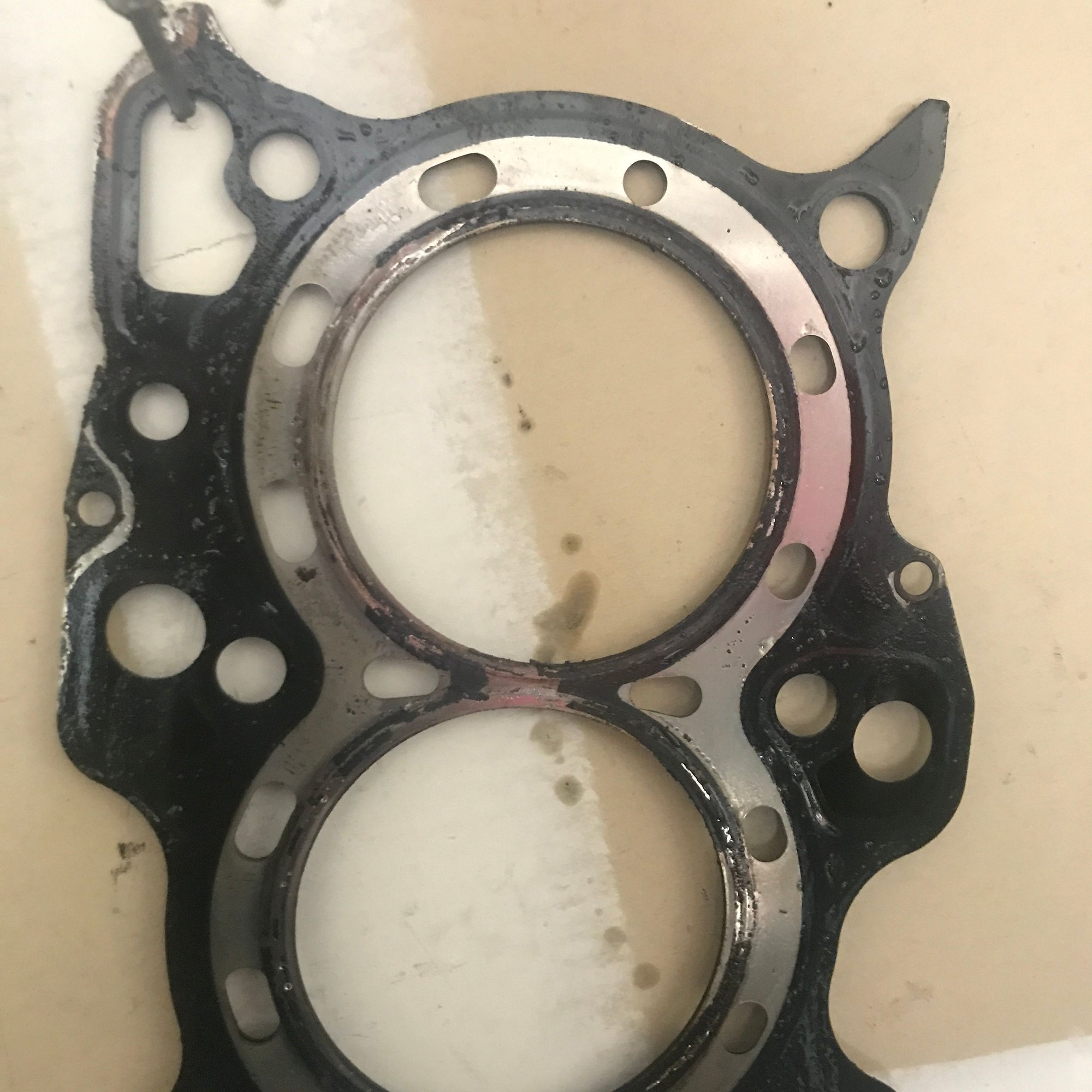

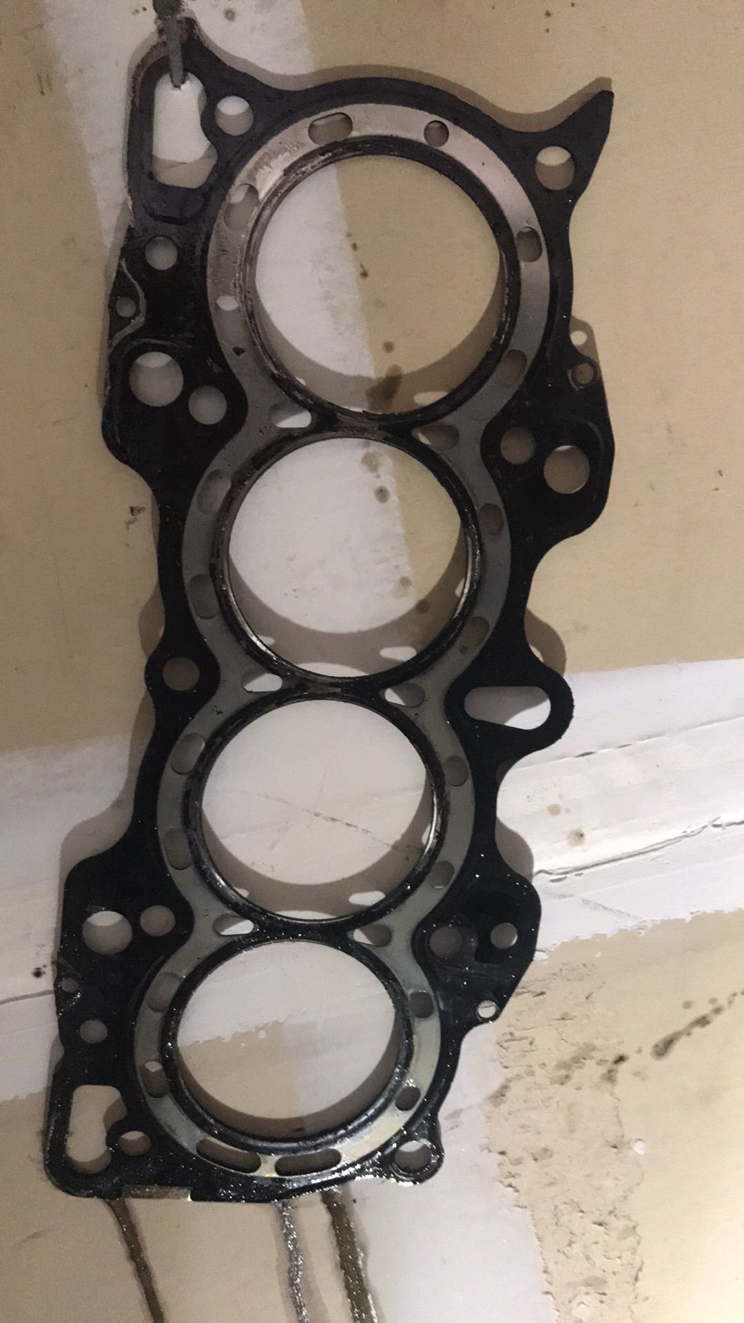

Alright! So! Another update, the old head gasket was super blown.

Originally Posted by wunfstgsr
Time for a new one and may as well slap some ARP studs in.
so, we put a new one in it. Given the B18A1 head bolts are not TTY type bolts they can be reused, which is what I did (which is something a lot of people here said you could do). Torqued to spec, in two steps, 22 and 61 ft lbs. aaaaand the car idle misfires worse than before. Curiously, I unplugged the map sensor and ran it for a bit, it idled at 1.5k with a CEL. I turned the car off and plugged the map sensor back in and the car idled a bit high, but no misfire for the entire minute it was running.
Old May 20, 2018 | 08:20 PM
Lord Orange's Avatar
Joined: Apr 2018
Posts: 30
Default Re: Extremely low compression?!
I hope you pressure tested and resurfaced head
Old May 20, 2018 | 08:38 PM
WestyNaut92's Avatar
Joined: Sep 2017
Posts: 54
I most certainly did not hah. It wasn’t overheating or mixing coolant and oil. I’m amazed the gasket was that blown. Also if I’m going to be real I’m 25 and extremely poor, I just didn’t have the money to get the head pressure tested and resurfaced. Also the engine got MUCH harder to turn over with the new head gasket, so...I think it was sealing well, haha.
(also, believe me, I wish I could do the job 110% properly. It absolutely bugs me not being able to do everything right, but I just don’t have the money to do so and my Integra is my only car. Had I had more money I would have gotten ARP head studs and a full gasket kit)
Old May 20, 2018 | 08:54 PM
Joined: Apr 2018
Posts: 30
Education is priceless.
it is only 75-150$ to pressure test and resurface. Now you get to do the job again. I don't understand on mission critical items like the minimum of a cylinder head pressure test. Your last move doesn't allow for any to further diagnostics besides removing the cylinder head again. Good luck with repair.
