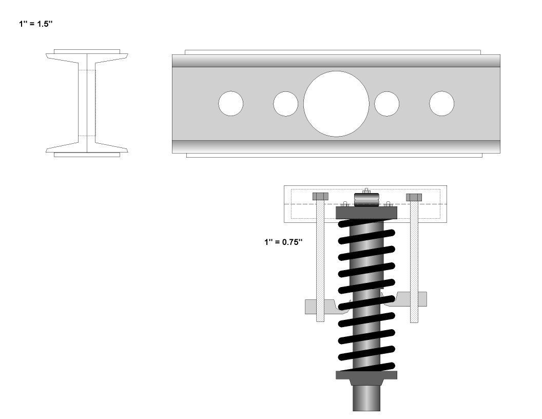

....or, I might get crazy and do this. I've got a couple pieces of T6 3" channel I used a few years back to build an engine cradle. It's strong enough for this....
If not I'll put the old ones on and wait till I'm back in San Antonio.
I just noticed the scale mark at bottom is wrong, oh well. One's smaller.
Old Aug 4, 2015 | 10:21 PM
1990IntegraLS's Avatar
Joined: Mar 2015
Posts: 875
Likes: 10
Default Re: Which coil compressor?
As drawn, it's not big enough. The strut top is a little over 4". A variation of it would, but possibly only for the OEM strut. The AGX comes with a bump stop terminated by a metal spacer and washer. Those pieces might interfere with compressing the top. Typically only the spring is compressed.

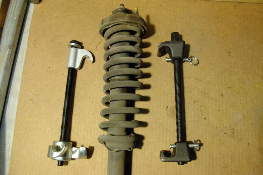

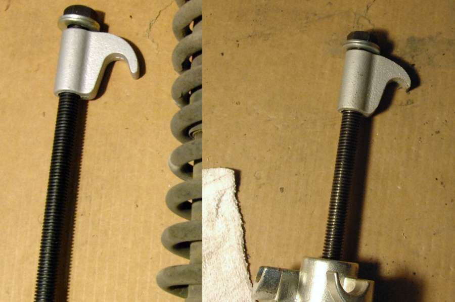

I later realized my 3" channel wasn't big enough, so I decided to risk grinding metal off the compressor.
You can see the difference. Of course I had to grind both.
I did rotate the coil to get an equal distance where I put in the compressors on each side.
Note below that the coil is off center. This turned out to be due to it being broken (both right and left wheel) at the bottom. The spring rusted and broke at about 3/4s of a turn, the flat part. I'm amazed the car drove completely smooth with no clunking or movement at all, very stable doing 25mph marked corners at 60. That's very surprising, but I consider my self VERY lucky, it would've eventually been a bad situation. So new coils are coming. Like the photo, I didn't see the break until I pulled the coil off.
I used the compressor on the right for the rear, and ground off a little metal on those to, to get them in. They wouldn't have come anywhere near going in the front. I will grind off a bit more of the compressor on the left to reinstall the new ones. The AGX struts need more room, so I don't tear up the boots. Hook screws came with the one on the left, so it's more secure.
