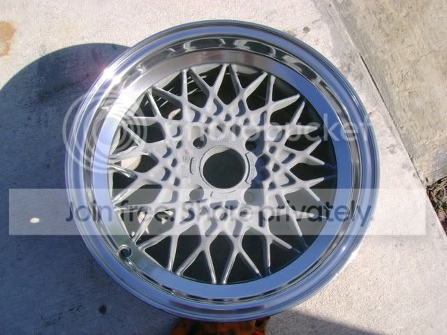

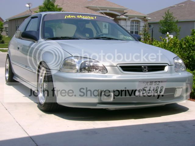

Hello, i purchased a set of bbs wheels a while back and it turns out the lug pattern does not match my car. I was given false information about the pattern when i bought it so I guess im stuck with the wheels. My question is, how can i find out what lug pattern my wheels are. The wheels are deffinitely not 4x100 or 4x114.3. Also, I dont have time to match up every different 4 lug to see if it fits. I would try to resell them if i knew the lug pattern of them, but if possible i would like to make it work on my ek hatch. I have heard of people redrilling into the wheels and also the hubs. The wheels themselves have little areas that look like they would accomodate that. If i were to do so, where would i go to get that done and how much would it cost? Also, another option would be to use wheel spacers, but they are a little too pricey for me, and also my wheels have a low offset as it is, i wouldnt want them to stick past my fenders. Any good advice would be greatly appreciated! Here is a picture of my one wheel i had been working on.

measure them first then resell them on ebay..i will take a wild guess and say they are either 4x108( old fords) or 4x98 (fiats)

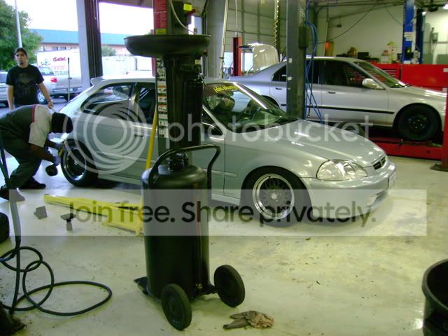

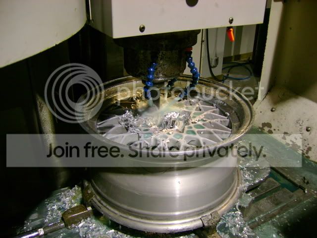

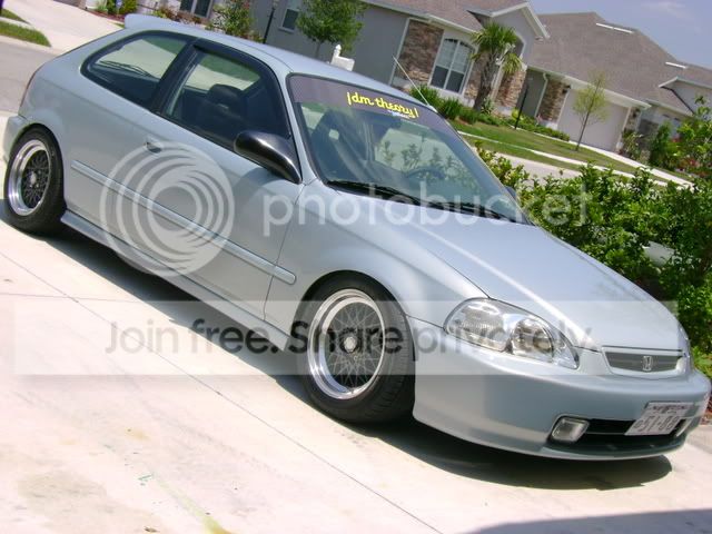

Sorry for bringing this up from the dead, but i had my wheels redrilled and they are a very viable option. It cost me 140 dollars total to do all four wheels. All the guy did was widen up the hole alittle with a special cad redrilling machine. He then hammered in metal ring that would support the studs. I am bringing this back because i remember i had trouble with options and lack of info on what to do with my wheels. Hopefully this will help someone else out.

what is he doing w/ that plunger haha..jk.... rolling the fender lips lol
so the rims were 4x108 right and he inserted them to 4x100?

Haha, yes that sir is a plunger and it isnt the best method to roll the rear, as it is pretty stiff. I just took a big hammer to it later. The man i took my wheels to get done was surprised i found out about him because he usually gets calls from dealerships( i googled him and his name popped up with a number). I guess this process is common among dealerships( atleast in my area).
