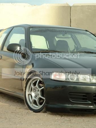

Old May 31, 2006 | 06:08 AM
Aarron_M's Avatar
Posts: 2,341
From: USA
Default Re: which offset to tuck the tires? (fast95eg8)
Car and tires are long gone now, but these are the best pics I have of em. Oh yeah, got em in Germany.
