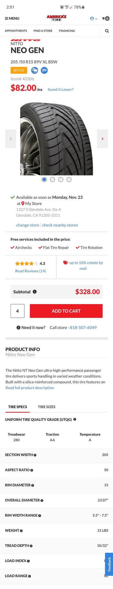

Looks like I have 1 last question after all.. In looking at various 205/50/15 tires, it shows recommended rim size up to 7.5" however I have a 8" rim. It says its only "safe" up to 7.5"...what are your thoughts around this?

It is probably for liability purposes, it isn't like putting a 165 wide tire on a 15x8 and for the most part looks really mild. Plenty run the slight stretch for autocross and track days and have not had issues and Grassroots motorsports have run tests with the 205/50/15 on a 15x8 setup for their tires tests. Just find a shop that is ok with mounting them, most probably won't care. I believe neogens might run a little wide so it might look similar to my pic below..
