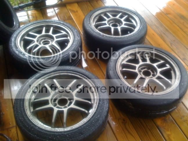

I just bought a use subzeros and I have no idea what the wheel specs are other than that it's 16inch. And it came with some Bridgestone tires with a 205/45/16 fitment, and I really don't like the way it looks on the rims, the profile is too low and I want something a little wider. Like I said i have no idea what the wheel specs are and neither does the old owner ( I have no idea how he doesn't know what the specs are
Any way I need some suggestion on some tire choice and their fitment, Please include some pics if you have any.
This is the only pic I have...

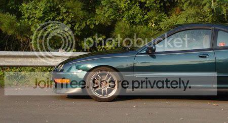

Sorry I should've clarify that, I have a '98 integra ls, I'm using the tires for daily driving, but I'm willing to sacrifice the tires lifetime for a better performance. I bought BFG touring pro series in 195/60/14 for my snowflakes not too long ago. It looked kind of meaty, rides very smooth, grips in the wet surface. That's pretty much what I'm looking for, I'm really looking for a little meatier look on 16s.
This is the only pic I have on the car...not sure if this helps

Then you'll want either 205/45-16 or 215/45-16. Either size will work. Choose the tire you want, based on performance, cost, etc, and get whichever of those sizes it's available in.
Recommendations...
1. If you want the best traction on dry pavement, and you don't care about so-so grip in rain or relatively short treadlife (10-12K miles is typical), get the Falken Azenis RT-615 in 215/45-16 ($97/tire at Vulcan Tire) or Bridgestone Potenza RE-01R in 205/45-16 ($158/tire at Tire Rack).
2. If you want very good traction on dry pavement, but you also want good grip in rain and/or longer treadlife (25-40K miles), get the Yokohama S.drive in 205/45-16 ($94/tire at Tire Rack) or the Kumho SPT in 205/45-16 ($83/tire at tires-easy.com).
3. If you will occasionally use these in snow and/or if you want even longer treadlife (40-60K miles), get all-seasons. The Kumho ASX in 205/45-16 is $46/tire at the Tire Rack, on special right now. I know that sounds ridiculously cheap, but the ASX is one of the best all-seasons you can buy.
