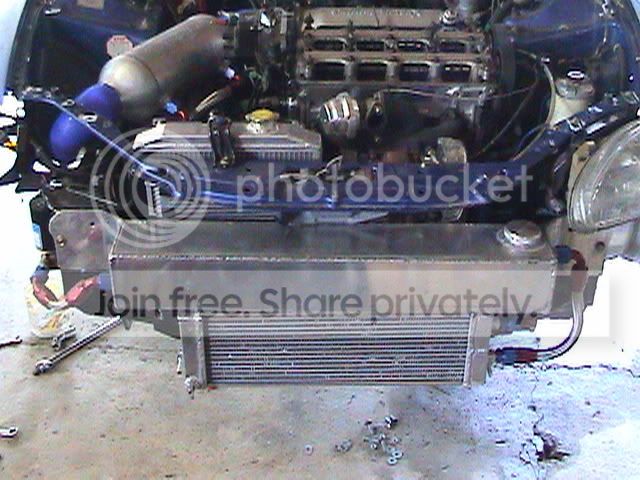

Heres mine
Old Sep 22, 2007 | 03:18 PM
granturismonut2's Avatar
Posts: 192
From: IL
Default Re: Watercooler Project ?? (Garage 808 Hatch)
I like that alot
what is that one the passenger side infront of the radiator and the charge piping?
not a very good pic of mine \/

Garage 808 Hatch's Avatar
Posts: 5,433
From: CRESWELL, Oregon, 97426
Default Re: Watercooler Project ?? (granturismonut2)
on mine there's the BOV on the bottom of the piping, and then that big black thing is an air scoop to get air through the radiator.
