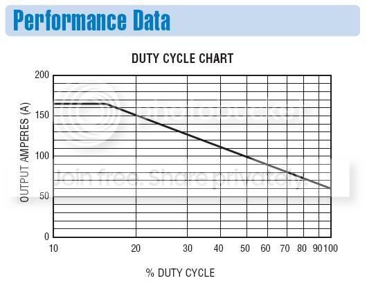

that thing prolly has like a 35% duty cycle @ 50amps

ROTARY's Avatar
Posts: 588

<TABLE WIDTH="90%" CELLSPACING=0 CELLPADDING=0 ALIGN=CENTER><TR><TD>Quote, originally posted by ROTARY &raquo;</TD></TR><TR><TD CLASS="quote"></TD></TR></TABLE>
ok not bad then
