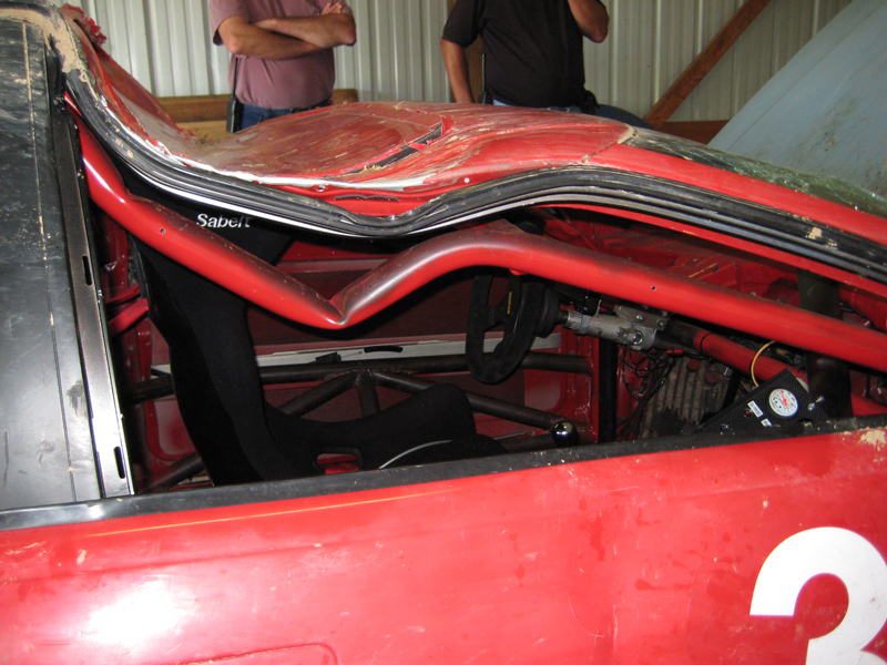

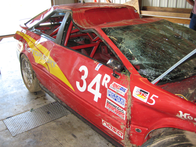

Thought some of you might want to see this. Taken from : http://forums.vwvortex.com/zerothread?id=4198394
Originally Posted by bulldogger72
for those wondering about extra bars- its not just rally cars that can use them. here is a track car that had a bad off, notice there is no A or B pillar bar, nor anything in the roof plane...
so again i will state- if you are looking to build a cage, at least look over FIA article 253, and build as much cage as you can.

that a pillar bar went right through his helmet...damn. strong *** main hoop to say the least

After looking at it some more.....did he roll it over and slide the roof into a pole?

I'm thinking the bar probably slid his helmet forward. Your head is already pretty far forward from the rear of the seat, but still.

yeah i understand what your saying, im sure it did, but when you first look at it, it just looks like it drilled his head.

FYI: The driver was medivac'd to hospital, survived, and is currently rebuilding that car with a new chassis. There's a lot more information over on BimmerForums; sorry, but I don't have the link right now.

Driver survived after being airlifted out, then went back to rebuilding the car in a new chassis. Cage was completely constructed of "1.750” x 0.120” seamless mild steel (DOM)".

Weird how the front upper pillar bar just colapesed.

The top tubes look like they ripped right off in the HAZ

what did he hit that didnt happen just from a rollover
why do those bent tubes look like cheap electrical tubing from homedepot.

He didn't just go off, he went WAY off. The roof went directly into a tree, right where that perfectly round dip is.

Wow...glad to hear the driver is ok. I was actually going to ask based on where that roof bar ended up...there isn't a lot of room for a head between the bar and the seat

Your roof hitting an immovable object like a giant oak tree is getting caved in no matter how serious the cage....this was just bad luck.

By no means am I an expert in cage design, but I think adding the vertical a-pillar reinforcements, along with the main rollbar to top bar brace would have helped tremendously.

There is a lot of space between that car's unibody and the frame some gussets would be a great add on that way they work together -_-.
