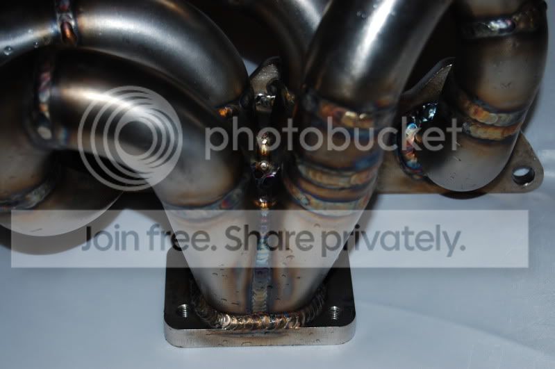

that looks like a subaru turbo flange.. what is this going on? and what turbo is being used?
It is indeed, its going on a Toyota Glanza, using a TD04 off a Subaru.

Did you weld the inside of the collector? Or is that the penetration from welding the outside?

Default Re: Race-Tech's fab thread
Inside also welded.

Originally Posted by RickyLee53
I don't use pulse on the machine, just on the pedal.
i thought you were using 3/32 rod
What does the size of the filler have to do with the pulse setting?
3/32 on the flange joints. 1/16th on the rest.
