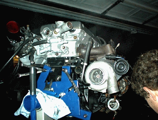

this is one of my setup
Old Mar 2, 2006 | 01:05 PM
enrike's Avatar
Posts: 128
From: montreal, quebec, canada
Default this is one of my setup
4g63 talon
g140/62/mvc008s2rq.jpg[/IMG][IMG][IMG][/IMG][/IMG]

i like to know what you guys think about it

I usually put the MAF before the turbocharger/supercharger since it's output is correlated to heat. Then you just throw the IAT sensor in the charge piping.

i spy xspower/ssac turbo and wastegate

Default Re: this is one of my setup (backpurge)
<TABLE WIDTH="90%" CELLSPACING=0 CELLPADDING=0 ALIGN=CENTER><TR><TD>Quote, originally posted by backpurge &raquo;</TD></TR><TR><TD CLASS="quote">I usually put the MAF before the turbocharger/supercharger since it's output is correlated to heat. Then you just throw the IAT sensor in the charge piping.</TD></TR></TABLE>
^ I'd do what he would do.
I'd put the MAF before the turbo if you dont have an air flow straightener on there.
It's not good at all letting the maf see all that turbulent flow.

its only the wastegate that is ssac
the turbo is a t3t4 garret
for the maf il chek but i se somme other peaple run the maf at this position

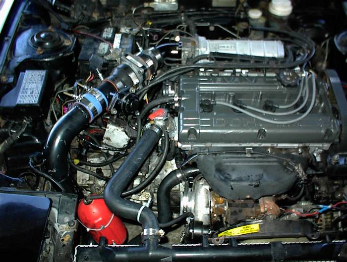

heres my old setup

Default Re: (SMS-Fabricator)
the DSM guys run that MAF setup because the stock ones are to small and it needs to be removed. th eGM is a blow through design and is the easyest to convert to. the stock DSM MAFs are way to small and limmit air flow. the GM 3" wich is pictured in most of these setups can be used as blow through or similar to stock with the preturbo setup. more luck and power has been seen with the blow through and its cheaper. and easyer to convert to. wish i had the money to put one in mine.
