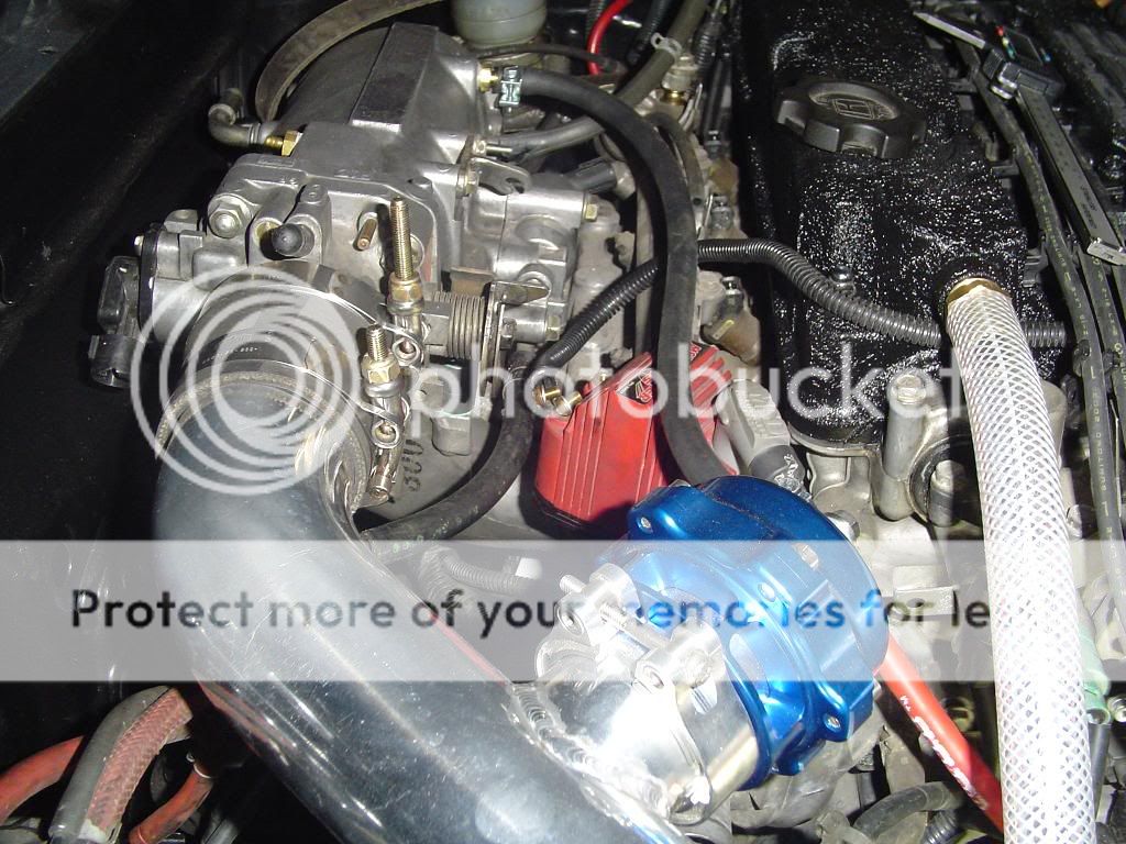

THANKS TO weirRacing FOR DOING SOME OF THE FINAL TIG WELDING.
everything fits.. so not it's time to play with the block.

o wow.. that's some clean work..
full drag car?
Old Dec 4, 2005 | 08:21 PM
*Boostwerks*'s Avatar
Posts: 9,455
From: I heart tool, US
O wow man...looks great...
I love the dumptube flex. It's cute...lol.
What turbo do you have bolted on there?
Old Dec 4, 2005 | 08:29 PM
2point2's Avatar
Posts: 5,986
From: Kitchener, Ontario, CANADA
Default Re: (Bryson)
<TABLE WIDTH="90%" CELLSPACING=0 CELLPADDING=0 ALIGN=CENTER><TR><TD>Quote, originally posted by Bryson &raquo;</TD></TR><TR><TD CLASS="quote">O wow man...looks great...
What turbo do you have bolted on there? </TD></TR></TABLE>
I got the flex bellow special ordered from the vibrant HQ (no warehouses had it in stock!)
57 trim t3/o4e .63... happens to be the same turbo that peakboost uses on their h22a kits i believe? i really wanted a GT turbo but got a good local deal on this.. it should throw the car around pretty good.

got any pics showing howlow that mani hangs the turbo, im curious, looks good.

it worked out pretty good.. i sanded down a fast-turbo.com fitting and tapped the fitting in further to get some extra height. I'll take a picture after i eat some breakfast!

looks awesome man. is that a true eq mani? i've never seen the design before. any updated pics?

are you gong to add a flex tube onto your downpipe? and is your downpipe "ovaled"? the fabrication is pretty good!

yes, a flex tube is going on, plus a bracket to hold the downpipe in place.. I dont want the exhaust putting any stress on manifold.
https://honda-tech.com/zerothread?id=1369488 &lt;--- downpipe info.

I'm estimating that it is ~ 1/4 el away from being equal length between the inner and outer runners.. close enough to be "equal length" i guess.

I wasn't able to use the fancy hardware for the return.. a couple hose clamps should do it.

looks good did you run the driver side piping through the front frame area?

nope, it went through the washer fluid hole.

Anyone else thinking some of those welds look hot as *****? Sweet design though.
