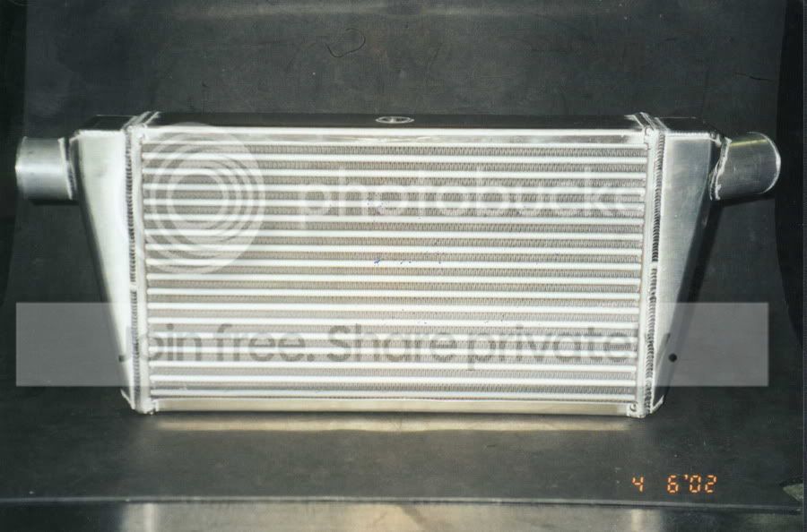

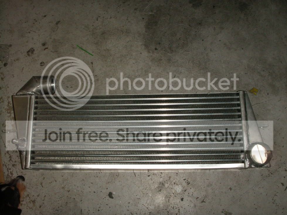

Heres a sidemount IC we've been developing for the 91-95 MR2 turbo using a Spearco core and our tanks.
And a huge 24x12x4.5" Garrett core based IC we made for a client in TX. This is going in his trunk in his MR2.

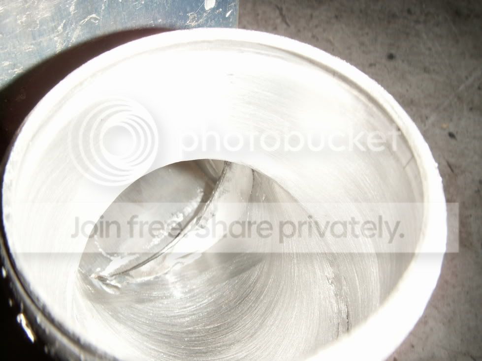

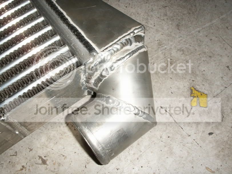

Here's a couple of pics from one I built some time ago here in Australia. I'm a big fan of pulse welding and it seems to work well for me. We are lucky here in that there are some very nice intercooler and radiator core manufacturers which will custom build to whatever you require. If anyone is interested in some very nice fabrication work here in Oz with some of the best technical info available anywhere, then have a look at http://www.are.com.au their attention to detail is world class. Check out their water to air coolers and dry ice coolers, the results are outstanding.
Regards Andrew.
