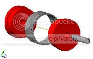

<TABLE WIDTH="90%" CELLSPACING=0 CELLPADDING=0 ALIGN=CENTER><TR><TD>Quote, originally posted by Canuk_SiR &raquo;</TD></TR><TR><TD CLASS="quote">I was thinking of making up some engine mounts as well, but where would you go abouts to find the bushings to fit inside the mounts? </TD></TR></TABLE>
I got lucky and got some chucks of urathane off my buddy - long story
I swear I read somewhere that mcmaster.com sells chunks of urathane. just buy some chunks, spin them up on a lathe into a shape of a T to fit some pipe and then stick in some sleeves in the middle and your good to go!
I made this pic up for my dad - he spined the urathane for me on a wood lathe , works perfect! He's got a ton of experience though..
