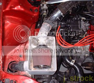

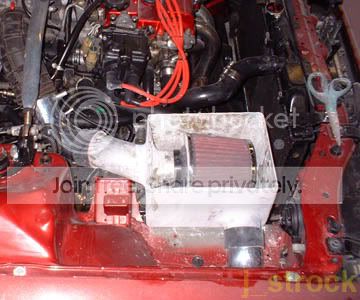

my setup my buddy made for me...
another pic of it in my old car...

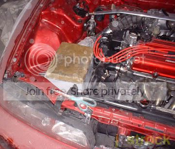

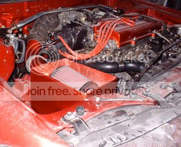

Heres a couple shots of mine I made out of metal tubing and fiberglass

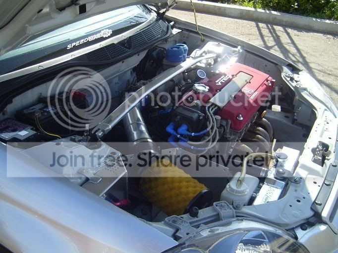

Here it is (installed on the car of a friend) my custom airbox named VP2 with internal big velocity stack
and here it is the variable flow version ( you can set the air flow according to your mods)
completely open air flow
completely closed air flow

Yes of course Matt. Let’s say that VP2 is an airbox chacterised by a large volume of air (about 10 liters) already
filtered and therefore immediately suitable for being injected into the engine. Inside the cylinder you will find a special alluminum stack finalised to increase air pressure and air velocity. Laterally a heating barrier prevents the sucking of warm air coming from the engine. The efficiency of the system compared with others AB just comes from its big volume and the fact that the internal airflow meets no further obstacle before the injection, eccept the throttle. Several dyno tests have been made compearing VP2 and Mugen AB which showed a prevalence of the first one in terms of horsepower and torque. As for the Variable VP2 this represents an evolution which further improve VP2 efficiency mainly to adapt airflow to the set up of different cars as well as the trackrace characteristics.
