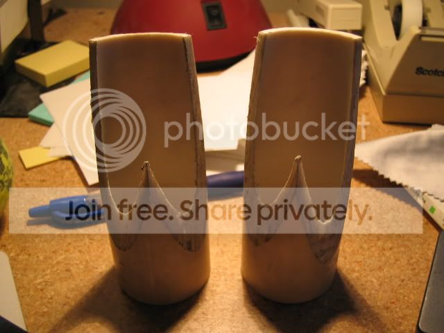

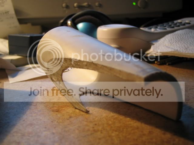

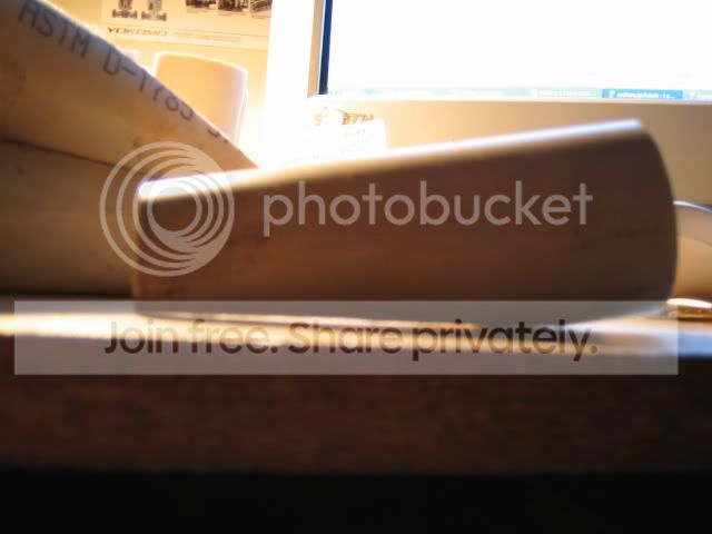

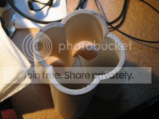

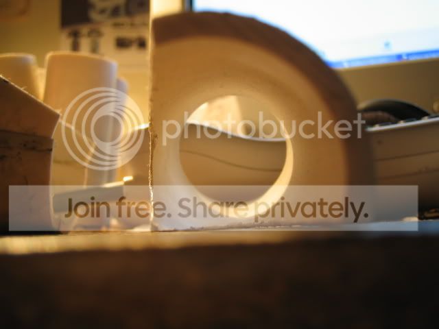

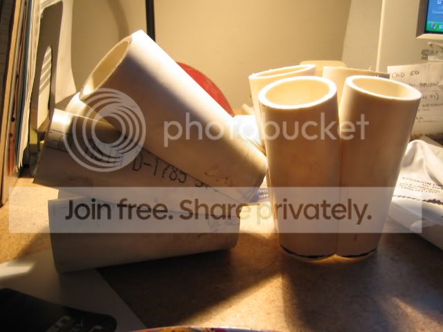

Anyway heres what I've seen on that forum, practicing cutting PVC with a bandsaw = good practice and cheap. thanks crx guy for giving me that link.

didn't think I'd host em eh? At least give some respect for not stealing bandwith
thanks for the pictures

fine with me, i was being sarcastic. its not my bandwidth, its fab-forum's.
finally someone is making use of those pvc collector images, woo hoo!

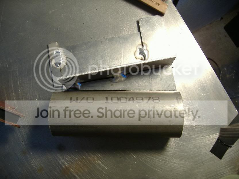

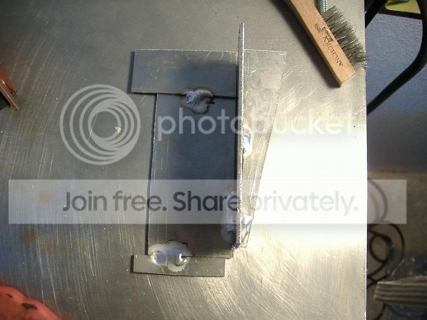

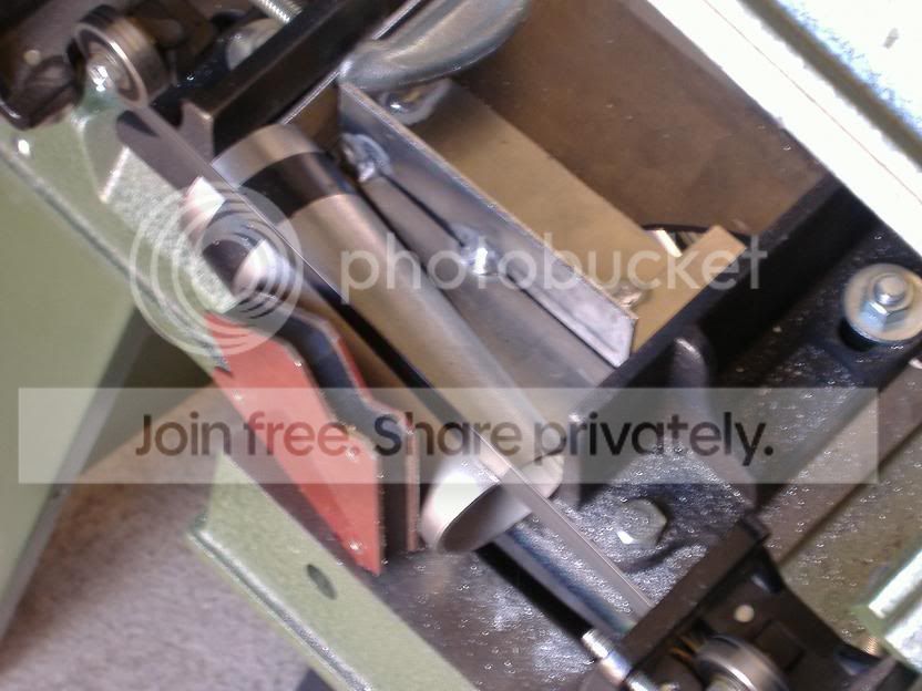

copied from a post on hmt

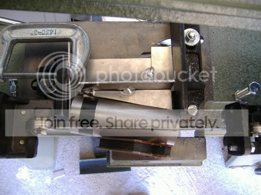

Here is the saw I'll be using.Ryobi 14"chopsaw,but you can use any 14" saw.
Here is the first cut.I use 5 inch length peices of pipe,set the clamp at an angle,clamp the pipe down and cut.
Cut #2,turn the pipe so that cut #1 is facing up(when you cut steel pipe make sure you start off slow or else the blade will want to walk)
There now you only have 3 more peices of pipe to cut.
Tack the 4 peices up and weld away.Here are some pics of the finished product.
