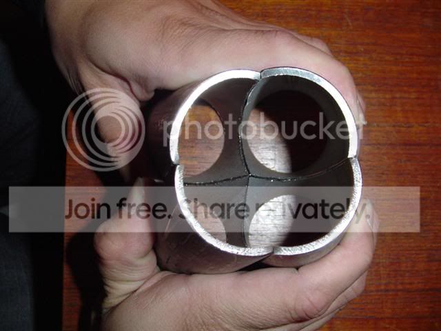

I found this picture on a VW board..
How do you cut and bend tubing like that?

Yeah basically I would like to know how to make one.
I've asked one manifold builder and he got all butt raped about ppl stealing designs from him...
I thought I was asking a general question? Oh well nevermind him.
So basically in this picture the tubing was actually a bend basically with a bunch half cuts?

<TABLE WIDTH="90%" CELLSPACING=0 CELLPADDING=0 ALIGN=CENTER><TR><TD>Quote, originally posted by MidShipCivic &raquo;</TD></TR><TR><TD CLASS="quote">
So basically in this picture the tubing was actually a bend basically with a bunch half cuts?</TD></TR></TABLE>
In that pic I'm not see this bend you guy's are talking about, that collector is cut from straight sch.40 pipe.

<TABLE WIDTH="90%" CELLSPACING=0 CELLPADDING=0 ALIGN=CENTER><TR><TD>Quote, originally posted by Dragline &raquo;</TD></TR><TR><TD CLASS="quote">In that pic I'm not see this bend you guy's are talking about, that collector is cut from straight sch.40 pipe.</TD></TR></TABLE>
Yah, there is at LEAST one post i remember with someone doing a walkthrough on DIY collectors. He made a simple jig to cut the straight pieces 2x at the desired location/angle. do that 8x (2x per piece) and then fit up and weld. If the measurements/cuts were accurate, it'll line up nicely.

Default Re: Collector techniques. (90blackcrx)
Just make some kind of jig all you have to do is take 4 equal length pieces of pipe and cut them on 2 sides 90 degrees apart from each other at the same angle

Default Re: Collector techniques. (snoochtodanooch)
buy some pvc pipe 1.5 inch sched 40 and expermint with jigs and when you figure it out cut steel its not that hard

Default Re: (MidShipCivic)
ya there are several posts about it. I even MS painted a pic of my collecter jig for a band saw.
There are no bends, its just two cuts on a straight piece of pipe. The angle and spacing I do not know.
