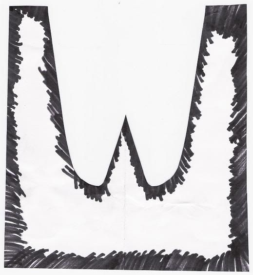

Oh Anyway I'm giving you guys a pattern for 1 3/4 to do this collector here

Here ya go finally I am having problems with getting it to the mail so here .Just print it .And cut it out.It should be 6 3/4 from the top to the bottom.
http://i16.photobucket.com/alb...1.jpg

did that do anybody any good? If not let me know why and I will explain how to use it.
The way you keep it 90degs is with a sander with a table that is 90degs from the face of the sander. Then just sneak up on it while your sanding it .OK? LOL
