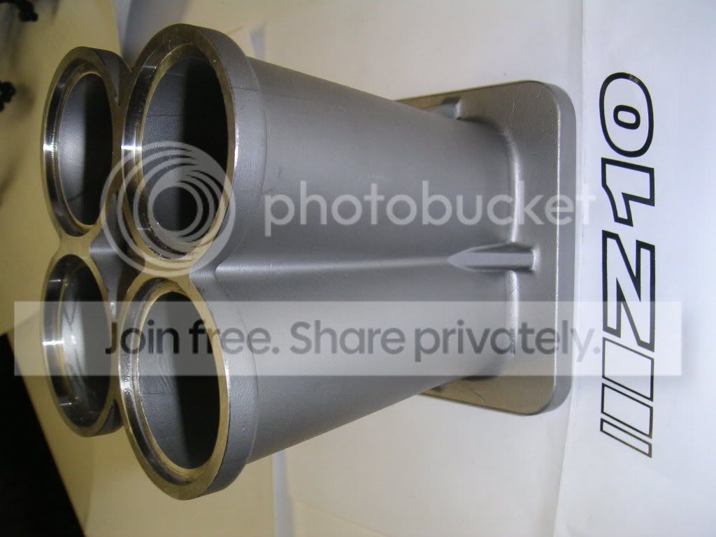

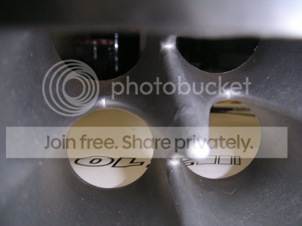

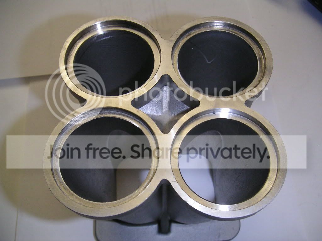

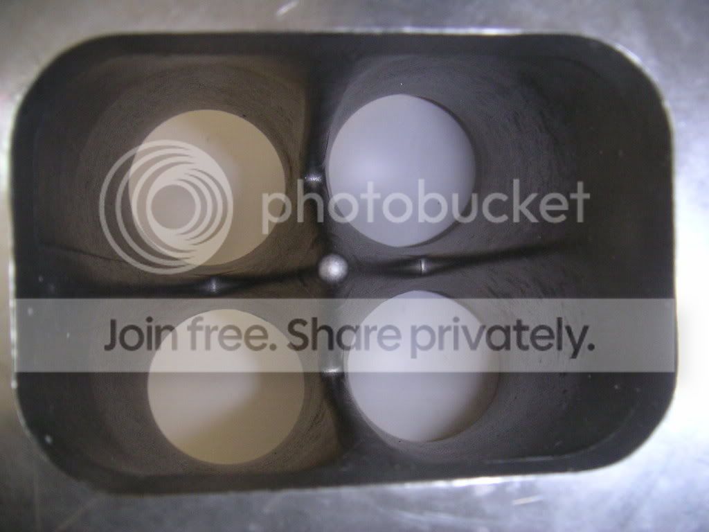

We have these in stock, they are stainless steel. Alot of work and research went into developing these.

Jumping aboard...prices And what the recess in the tops are for as far as tube size is concerned...

The collectors are 150 each with quan discount available the collector has a t3/t4 flange and comes drilled. They are set up for 1.5 inch ID pipe or tube. The relief in the top fits 1.5 sced 40 pipe fittings. The finish is as cast. The weight is 4.7 pounds, it equivalent to a schd 40 collector. The wall thickness is for fatigue resistance.
