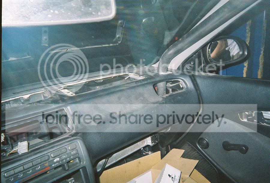

i ran my pillar bars through the "Honda" dash vents, then made two cuts so i can remove my dash in and out. you can kinda see one of the cuts on the right side of the bar.

I did the same thing for my down tubes. Ran them through the vent and cut a big slit so the dash could be pulled out.
Worked pretty well.

I see it all the time and think it's incredibly unpractical.
I had the front-most corners of the dash notched as to be able to remove and reinstall the dash at any time, looks clean and is functional

Mine goes through the dash, and the dash is not removable, and it sucks, considering I want to swap out dashes, and need to remove the dash in order to cut the old one out.
Next dash will be notched for the bars for sure!

here are some better pics of what i did. and another thing, something i noticed at the lucas oil divisional races, a lot of the superstockers put their brake master cylinder underneath the dash, just to get one less thing out of the engine bay.
