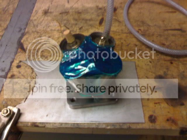

at work we just stuff the end with aluminum foil and use a standard regulator line with foil wraped around the end to seal it to the pipe. i set the flow to 20cfh dont worry about the gaps in the pipe unless they are more than 1/16" they dont seem to affect anything.
you can see the aluminum foil around the hose in this pic:

Old Jun 27, 2008 | 05:09 AM
