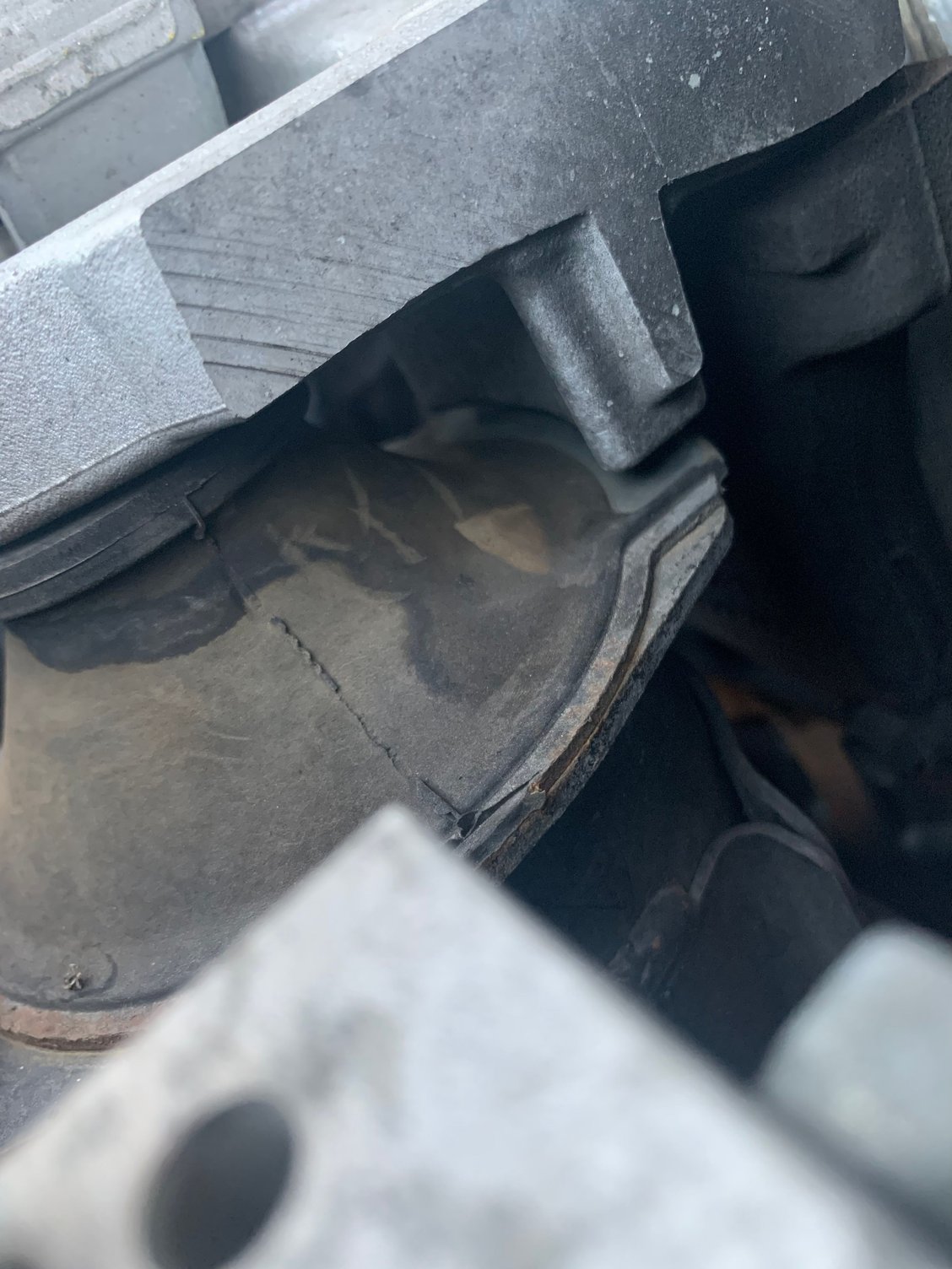

here is one of my actual mounts. Idk what the discoloration is but I don’t see any cracks? This can be pulled up on…

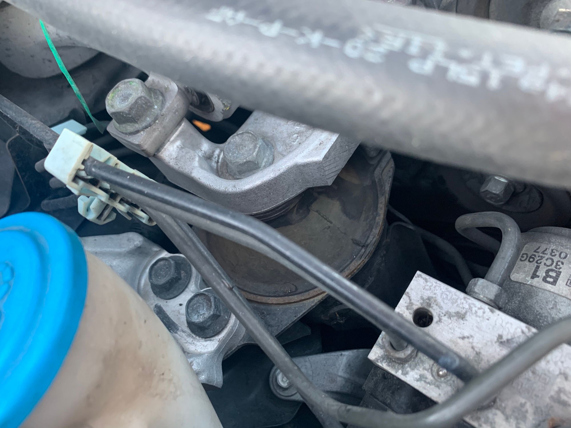

Second picture, upper torque mount is the one just out of sight under that AC line. The dog bone shaped aluminum bit.
The lower torque mount is bolted to the oil pan and goes to the sub frame. Also a dog bone shape.

oh yeah I’ve got replacements on the way. I just wasn’t sure if I needed to replace this one as well. I appreciate all the insight for sure!!!
