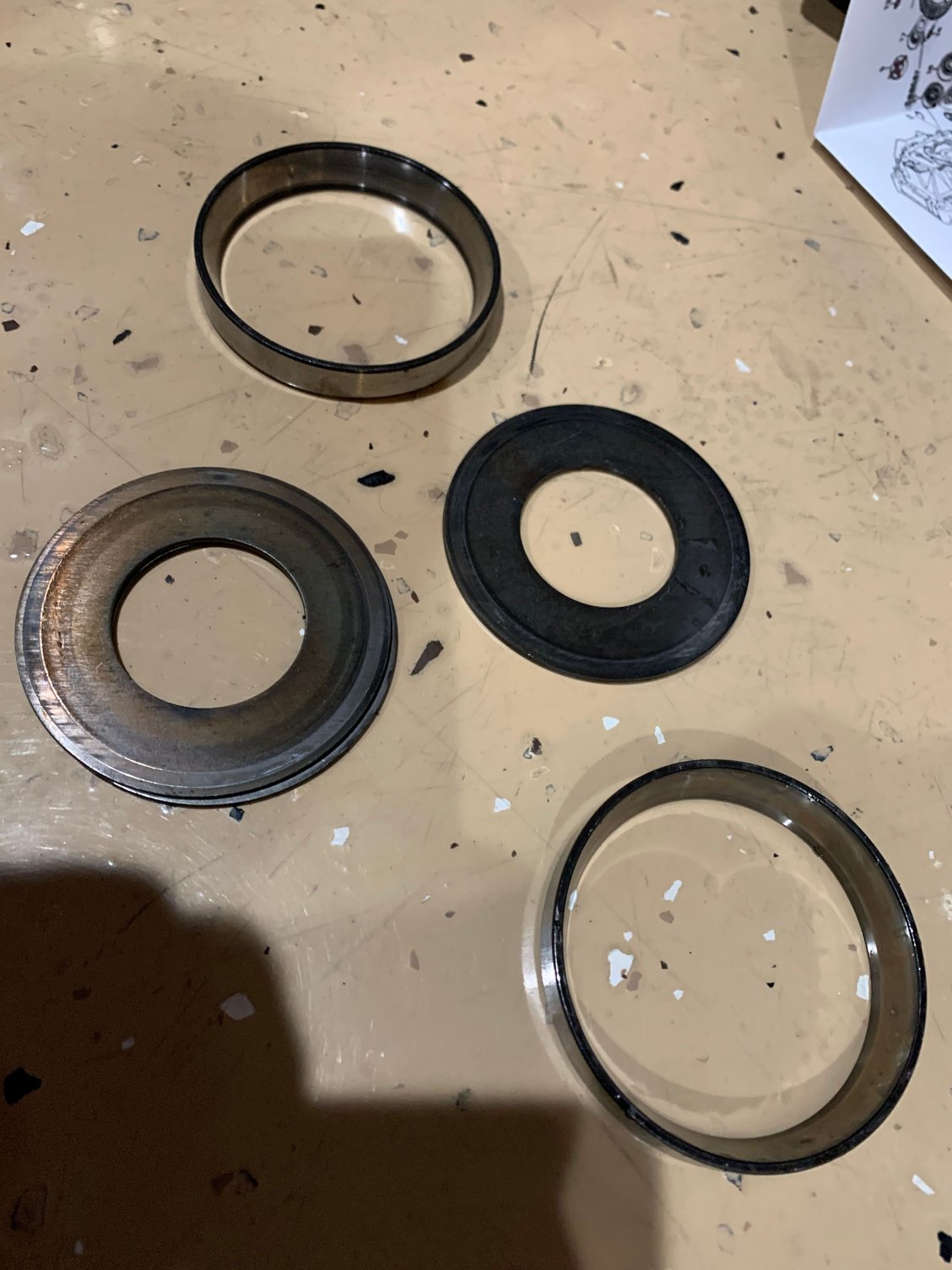

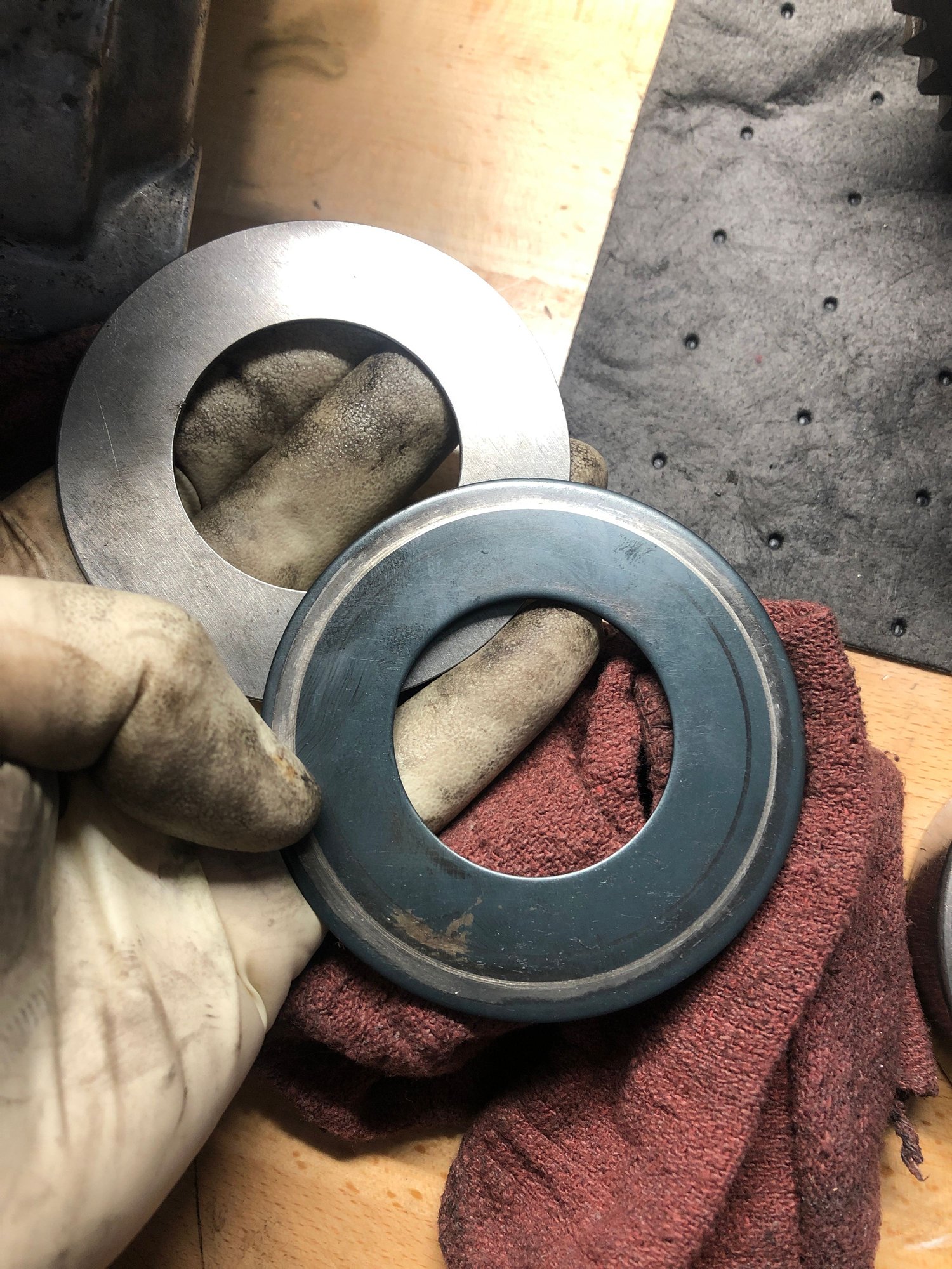

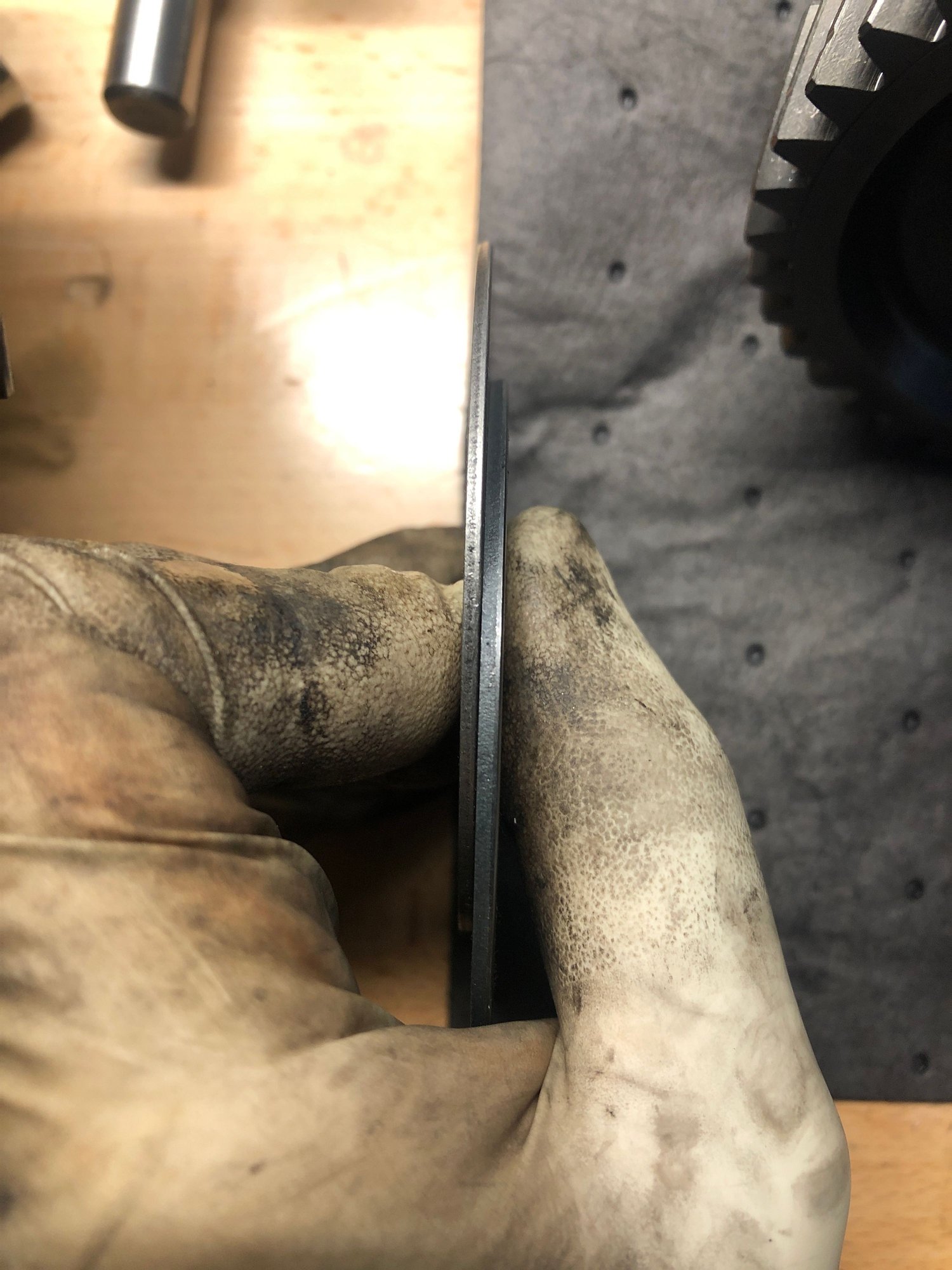

I don’t have a mic to measure these at the moment but obviously the black one is a little thicker
Both stock shims im assuming

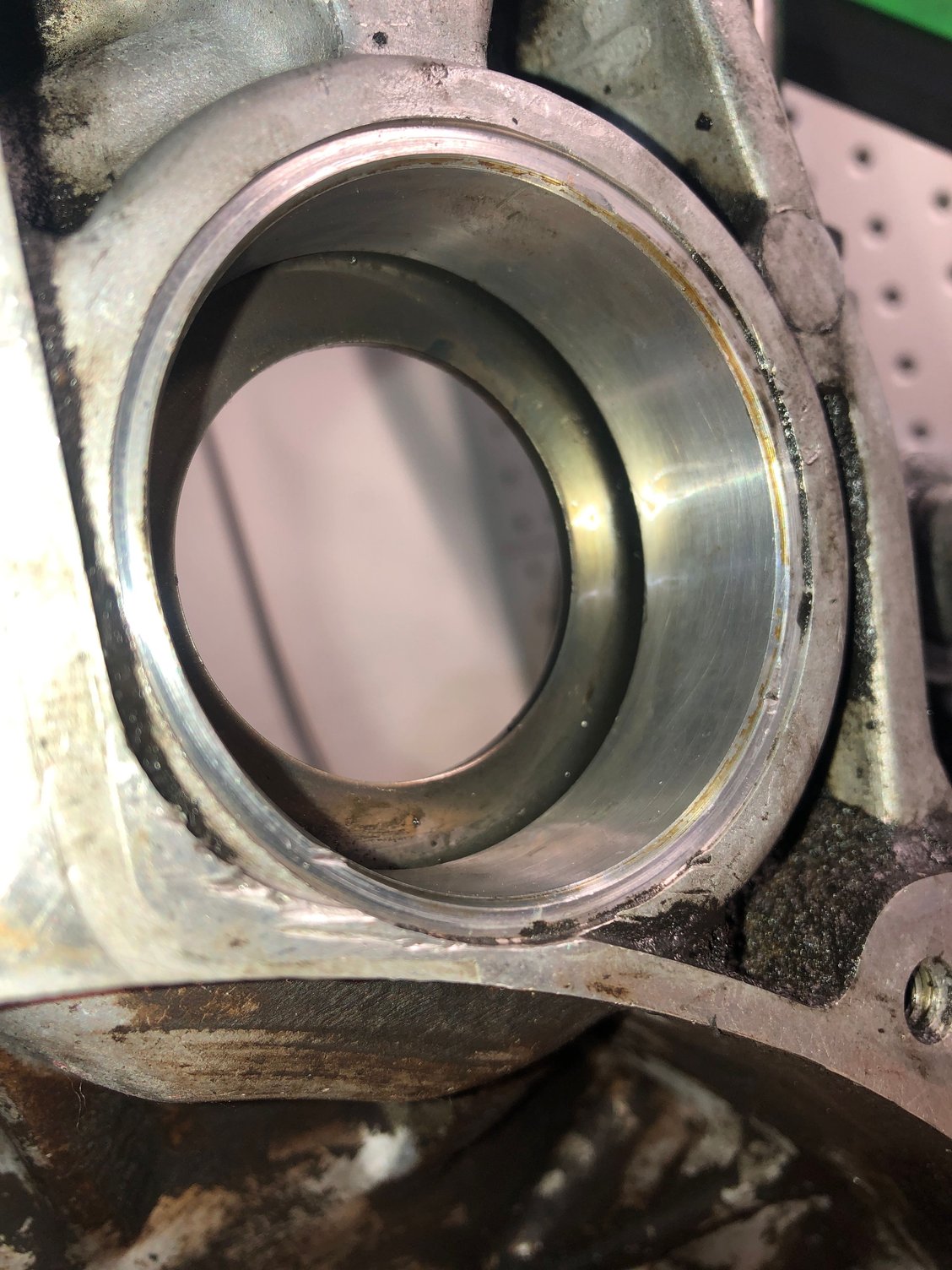

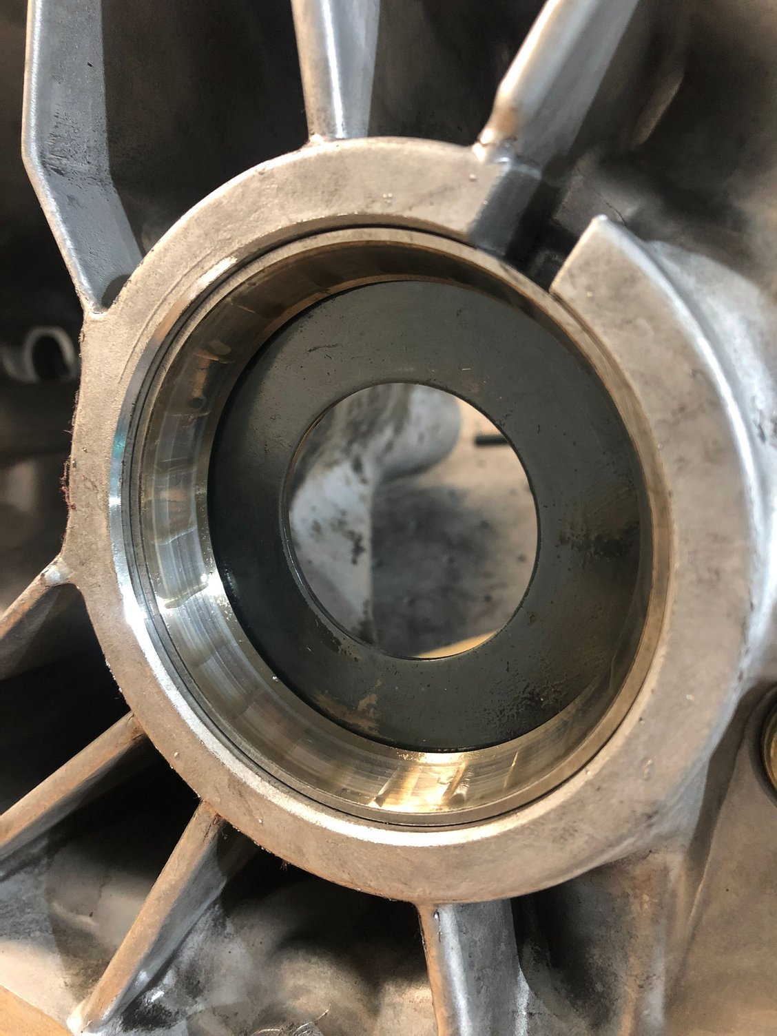

Can you share a pic of the trans case where the diff drops in to without the diff in. Both sides.

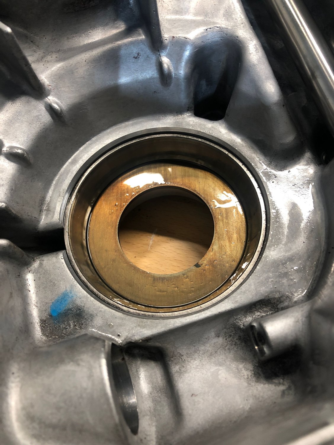

Default Re: Mfactory lsd shims ?
Trans housing
Clutch housing were diff sits
Outside of clutch housing

I think you need to bang those cups out... I just did this on a 96 GSR two-ish months ago... I’m racking my brain trying to remember what I did. These are the parts I removed from the each side of the trans case to ge the new bearings and diff to sit in correctly.
