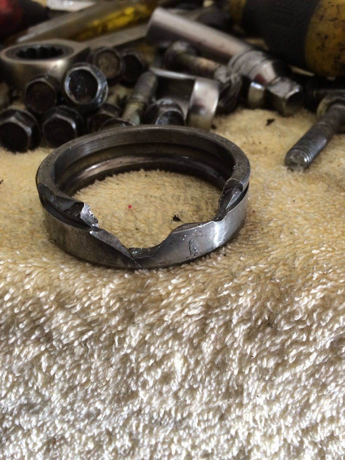

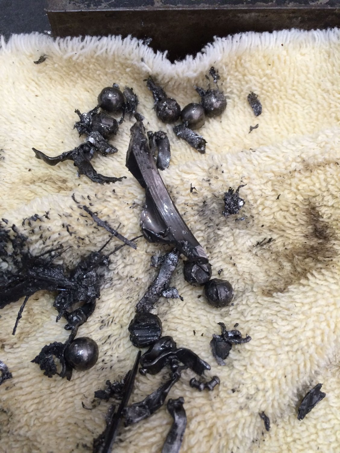

I didn't get a chance to Identify the transmission but here is what I found when I got it on the bench today. From the pictures can anyone tell if they see any major issues besides the obvious grenaded bearing?
First thought.... I' screwed.
Once I got it apart it wasn't as bad as I expected.
Pulled all of this out before separating the case.
the other half of the bearing
I see some damage but what do you expect with ball bearings bouncing around

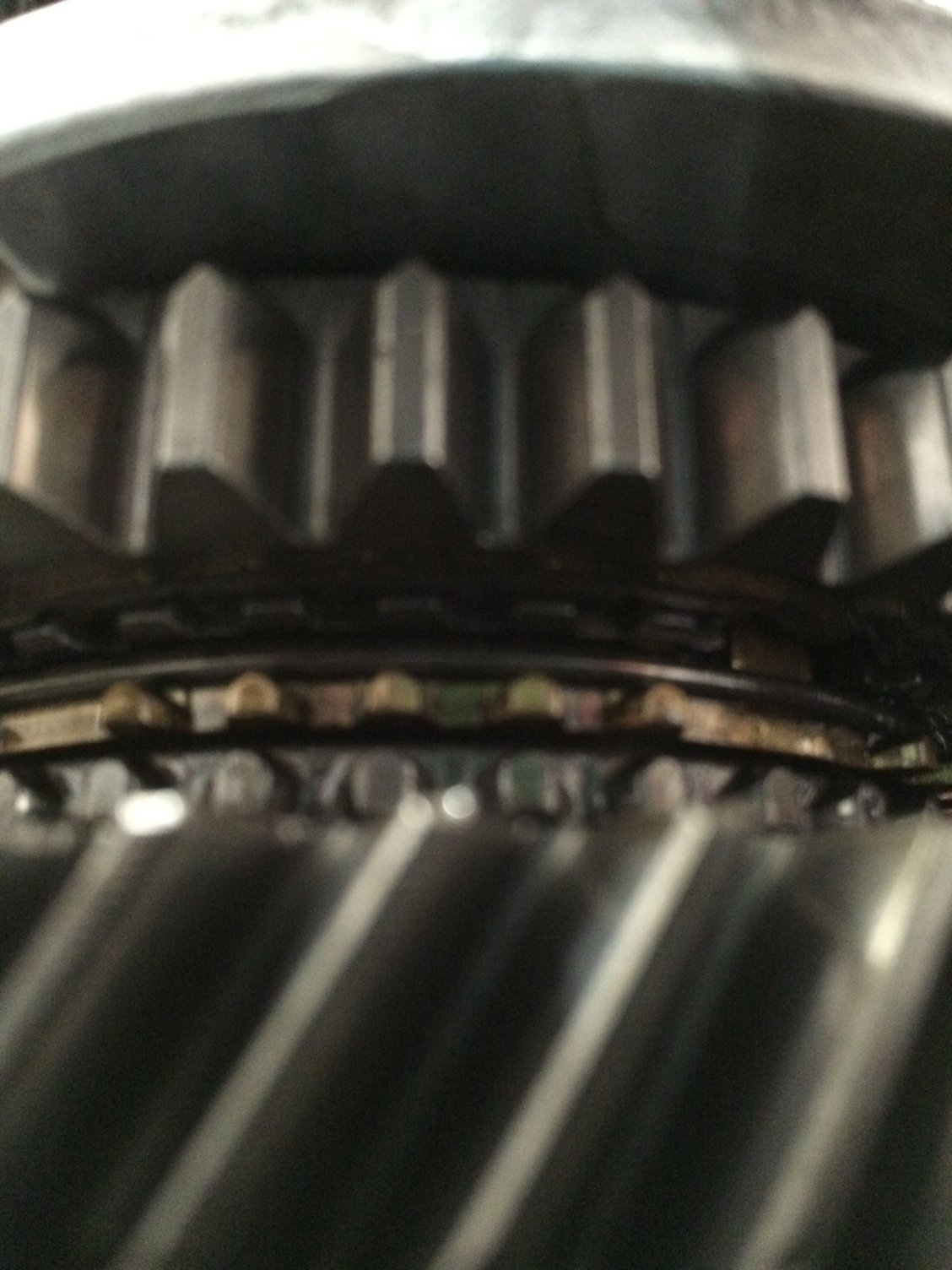

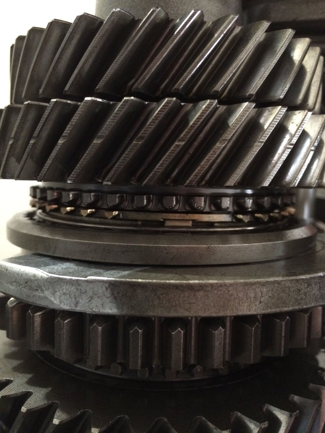

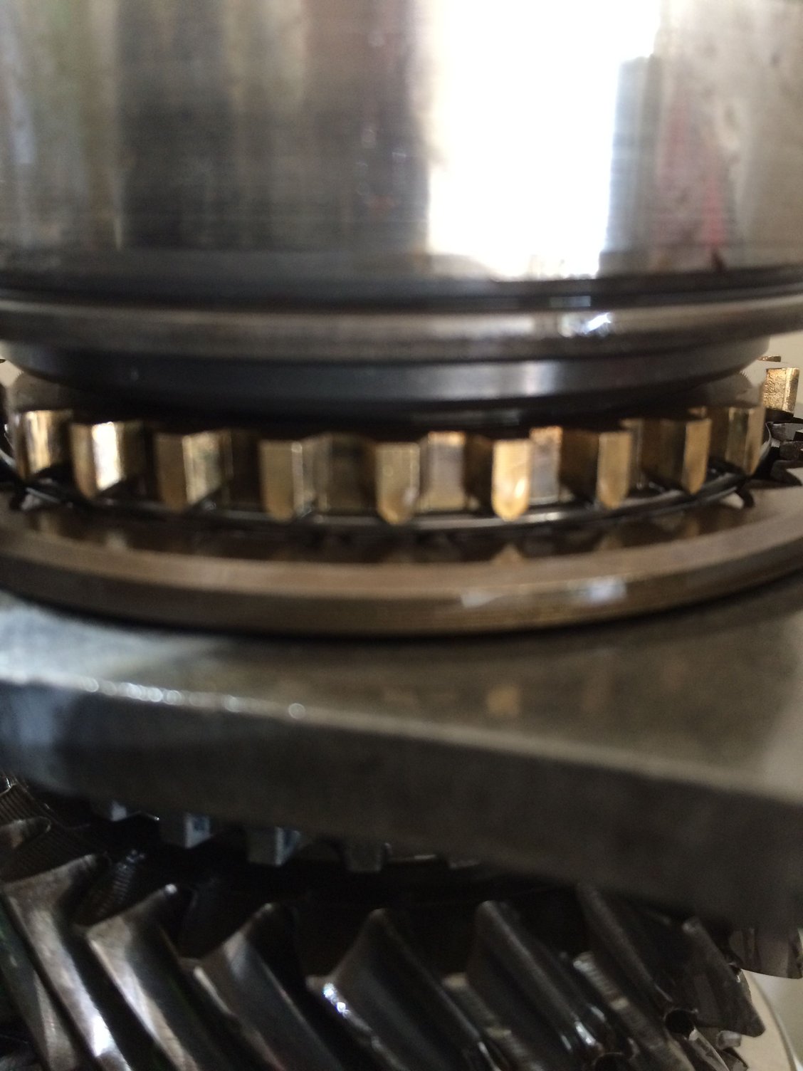

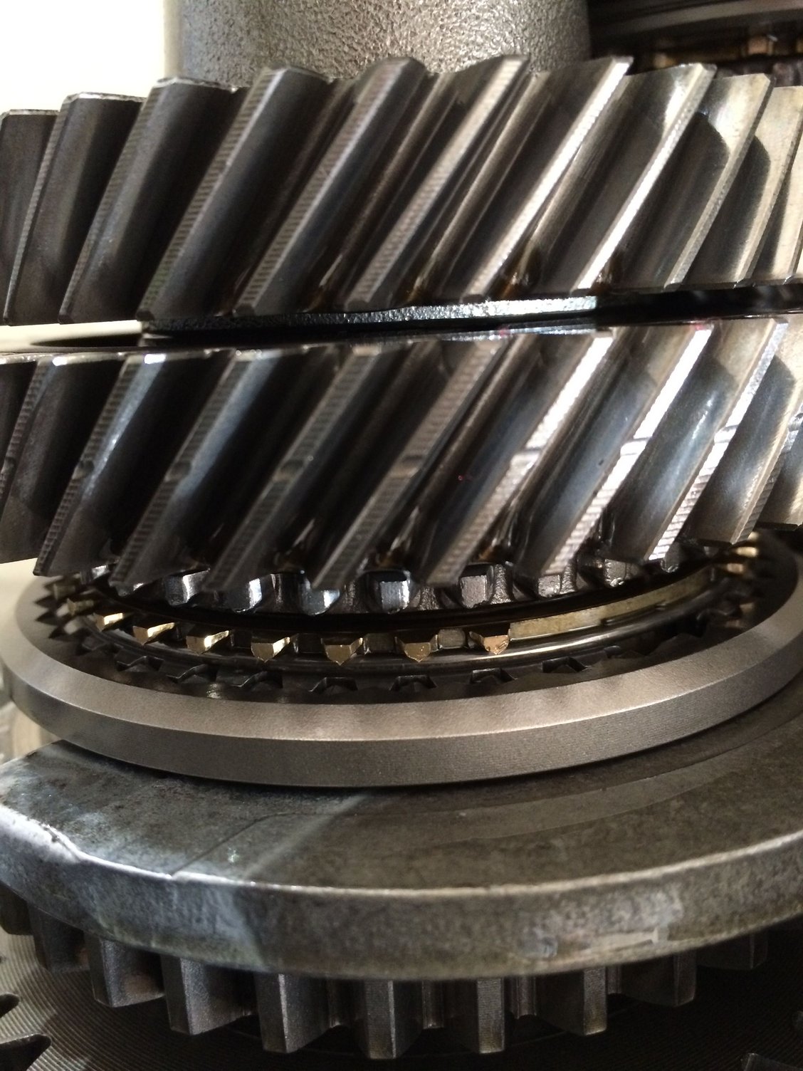

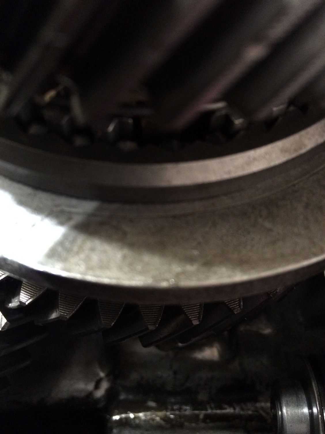

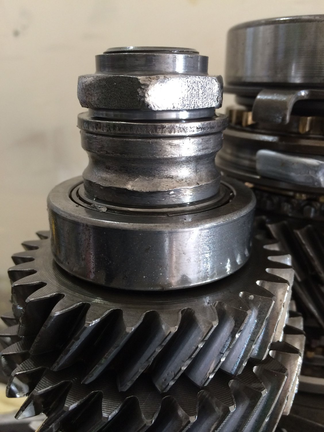

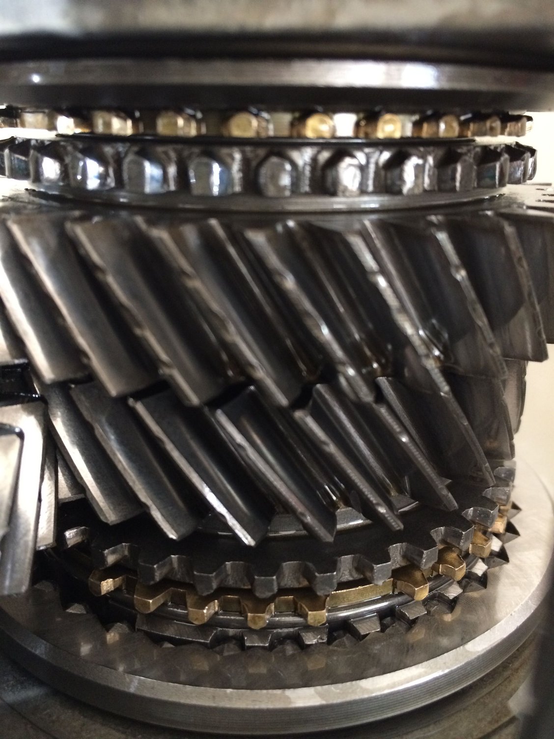

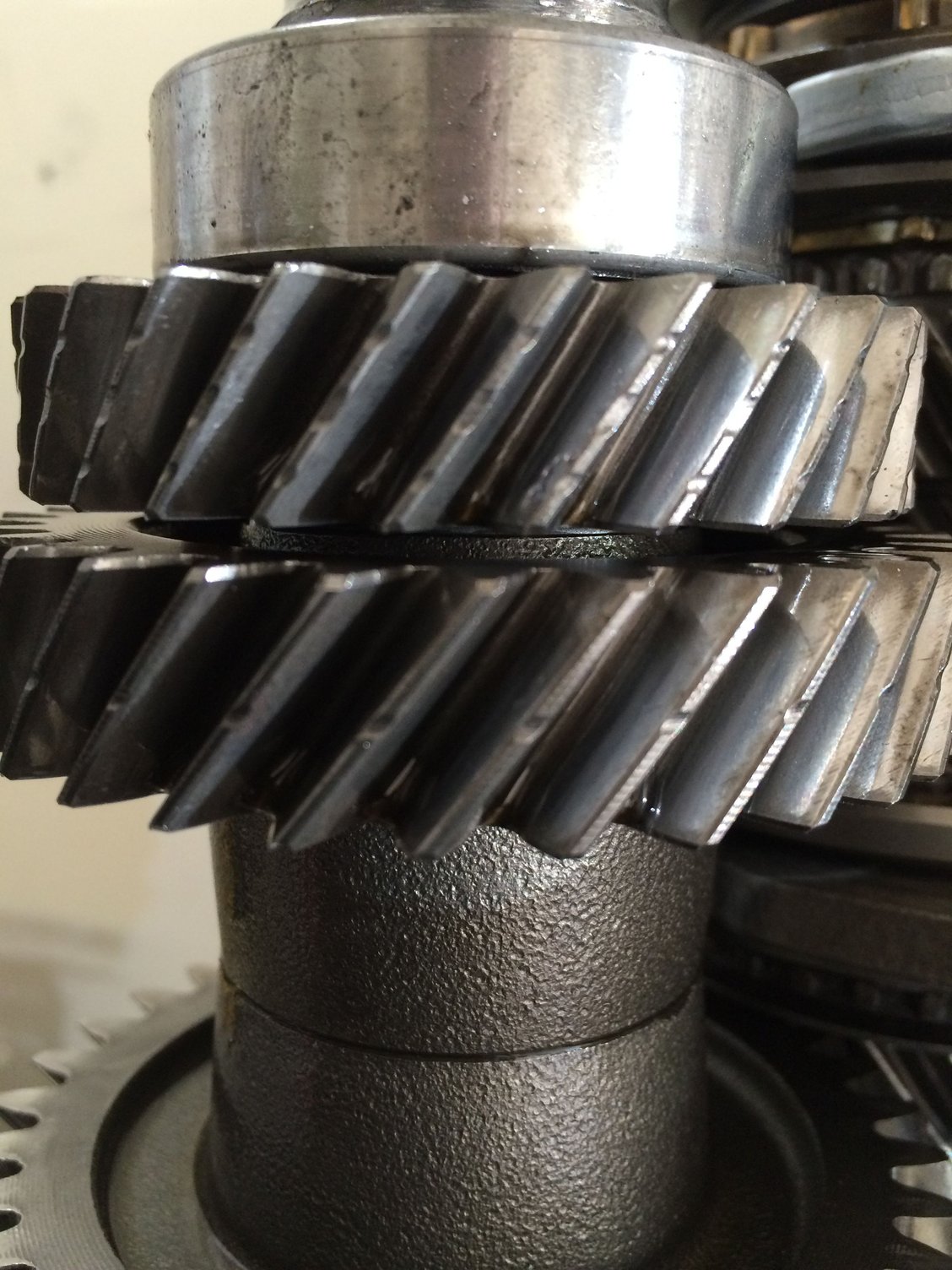

Took a few pics of the 2nd gear Syncros and such. Maybe someone could identify if they should be replaced. Looks pretty good to me.
Old Oct 16, 2015 | 10:51 PM
holmesnmanny's Avatar
Joined: Dec 2008
Posts: 12,028
Likes: 5
Default Re: LS Transmission Reverse Issue
The dog teeth on that gear look severely rounded. I would replace that gear along with a complete full synchro and synchro ring replacment kit.
That's the good thing about driving a transmission before you pop it open. You normally already have a good idea what you will be replacing.
