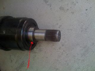

I found the end of the axle teeth rounded off...
Ok, so I need a new axle...

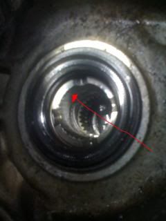

As i'm installing the axle, I notice I can shake the joint housing that goes into the tranny. I look closer at the diff...
It seems that this part of the diff...
...was honed (so to speak) by the first axle just jumbling around there when it popped out.

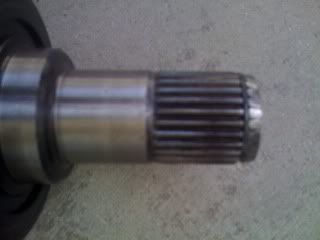

Now this part of the axle...
...won't sit snug inside the diff and that's why I can shake the joint housing up and down.
But that still doesn't explain, at least to me, why the axle won't go all the way in. You figure if it's bigger, it would still go in even easier. The snap ring does go far enough in though because I can't just pull the axle out. I need to use a pry bar.

your dif is prolly fine, the part that you said was "honed" has nothing to do with holding the axle in its place, the inner part with the splines is where it holds, that little ring on the end of the axle is what makes the "snap" or "click" sound when it pops in or out, thats what holds it into the dif..
My guess is, is that u ruined the old axle, thats clear maby the the ring on the end has been warn as well as teh splines, it needs those end splines as well to stay in place, i would for sure replace the old axle with a new.. you said you tried to put it in but it wouldn't go in?? Is this your 1st time putting a new axle in? because sometimes they can be very stubborn going in..
you really have to push hard and work it in as weird as it sounds, then grab the very end nearest to the transmission once u think youv gotten it and try and yank it out, it shouldn't come out by pulling so if you cant just pull it out then your good...
My guess is the oil burning was itt running out because when u put the old axle back in, since it was damaged it did not stay all the way in causing fluid to go by it leaking out the seal..
Buy a new axle, push hard making sure it snaps in place, be careful not to damage the axle when it goes in, check to make sure it wont just pull out, and you should be golden man...
Hope this helps...
Hope this helps...
