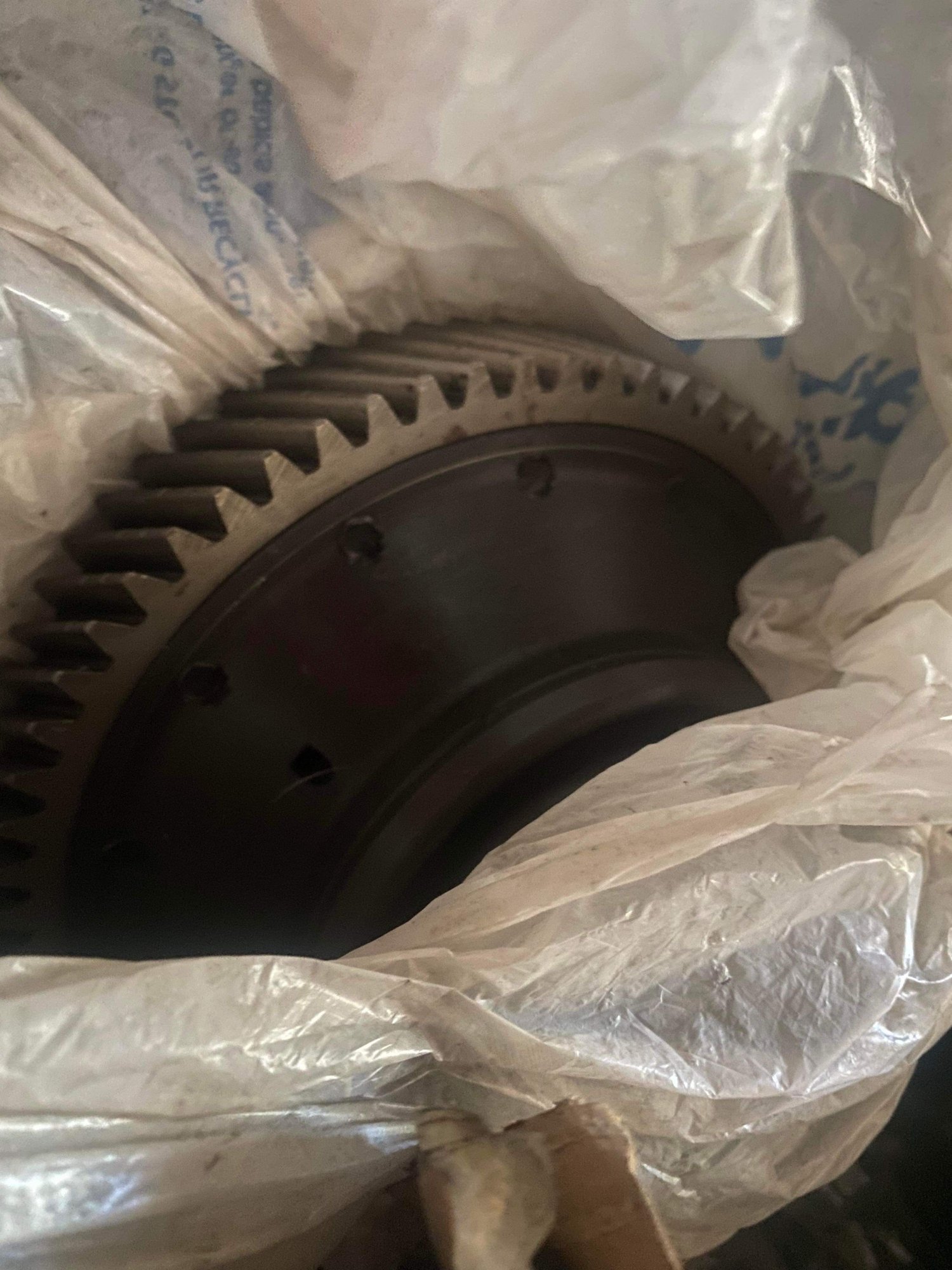

I’m being told this is from a b16b ctr transmission. Could anyone help me identify if that is true. I know ctr/itr transmissions have dual cone synchros but I can’t tell.

Start counting teeth

teeth on the diff?

Not CTR. That is a viscous LSD, CTR had helical.
