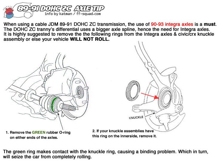

The correct way is to use 90-93 integra axles and a ZC half-shaft. If you do this you need to use the Si (or DX?) knuckle & hub assembly's as well, because the 90-93 integra axle-end splines are too big for civic STD knuckle/hub assembly's.
also, you need to do this easy mod when using 90-93 integra axles:
http://www.ff-squad.com/tech/t...p.jpg
