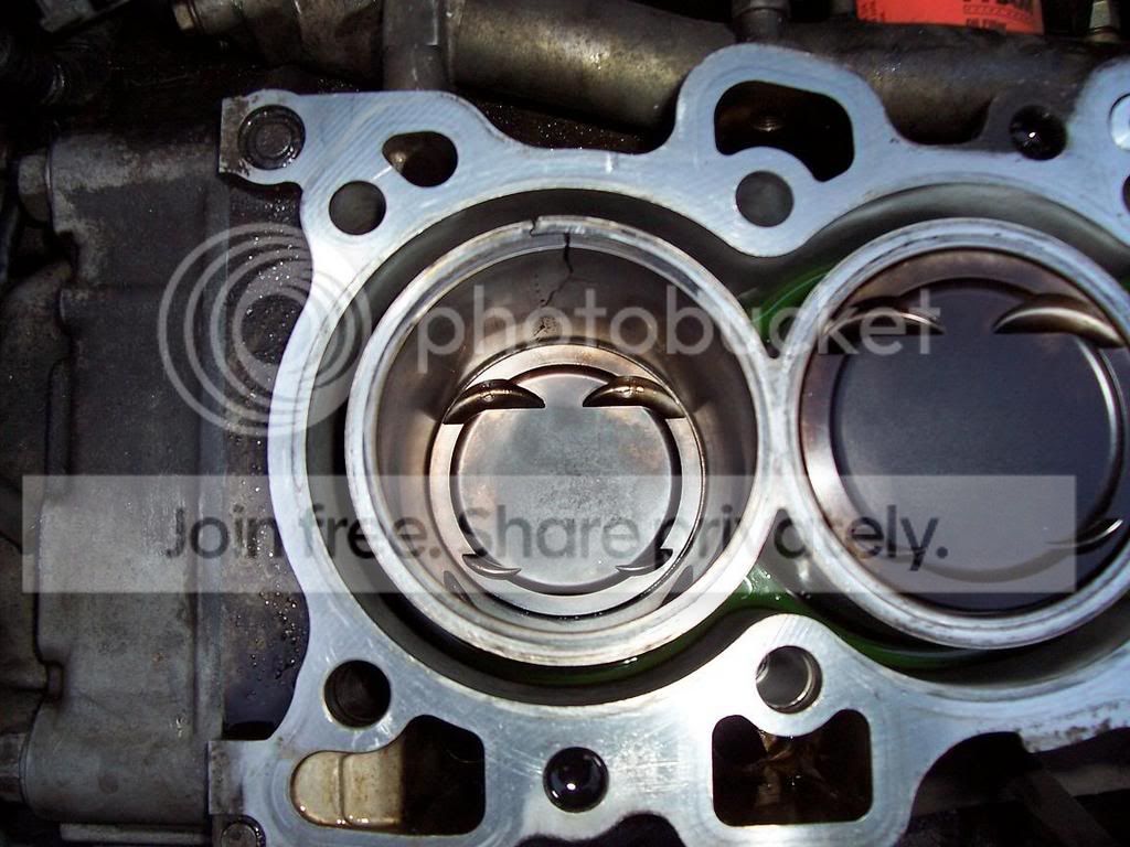

here my dyno graph to my car when my motor blew after picking it up. it blew the next day cracking the stock sleeve. But the thing is i drove it four hours home, and it drove fine. But i stop and got mid-grade gas because they ran out of the preimun grade and i was running out so i had to get gas. So the next morning i let the car warm up for like 5 min and drove it for about 5 miles and puch it in first around a corner and BANG white smoke..
Question is what might have made it blow, it was running fine home. cause it be the cheap gas? or that the car wasnt warmed up completly?

<TABLE WIDTH="90%" CELLSPACING=0 CELLPADDING=0 ALIGN=CENTER><TR><TD>Quote, originally posted by laziebun &raquo;</TD></TR><TR><TD CLASS="quote"> i drove it four hours home, and it drove fine. But i stop and got mid-grade gas because they ran out of the preimun grade and i was running out so i had to get gas. So the next morning i let the car warm up for like 5 min and drove it for about 5 miles and puch it in first around a corner and BANG white smoke..
So you had it tuned on premium gas, then you ran it on cheaper fuel. The lower octane probably caused detonation.
I accidentally put cheap gas in my civic after being boosted for 5 years, it blew the ring lands out of it before i knew what happened.

Did they retard the ignition time at all? If they didn't then that could have been the problem. By retarding the ignition time you move away from the detonation threshold. You lose a slight amount of power but that can be compensated by better fuel or an intercooler. Both better fuel and an intercooler allow for more timing without the threat of detonation.

by putting the cheaper gas in it after it was tuned with premium will definatley cause a detonation because of the compression ratio if either its boosted or just a jdm motor u should always burn premium if thats wat it was tuned with so i would say the fuell u used sorry for ya loss
