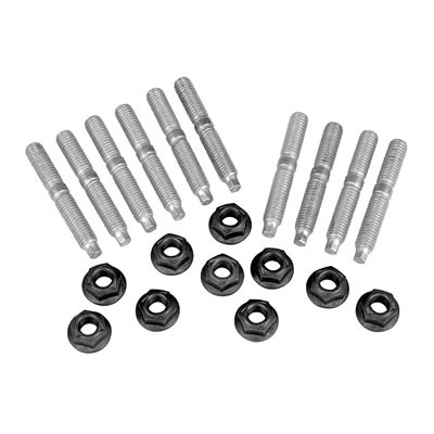

so, i decided i would check my old place of employment (advance auto parts)
and just check to see if they had some intake studs that would work
and low and behold i found some in the "help" isle
Dorman part # 03411
it's a 10 pack of studs and nuts for about $15, 8mm x 1.25 x 50mm
they worked great and even had a convenient 5mm hex on the end of them to make installing them pretty easy
they're meant to be used for ford/lincoln/mercury 4.9L exhaust studs

Dood, the threaded side that goes into the head is too long (62mm)
Here's the specs: http://www.autoparts2020.com/rsdev/p...T_HDR_ID=77730
How did you not have that problem?
I'm going to have to cut the studs.

Yeah, you had said that they were 50mm long. If you click on the link, which is the part number, they are 62mm long.
