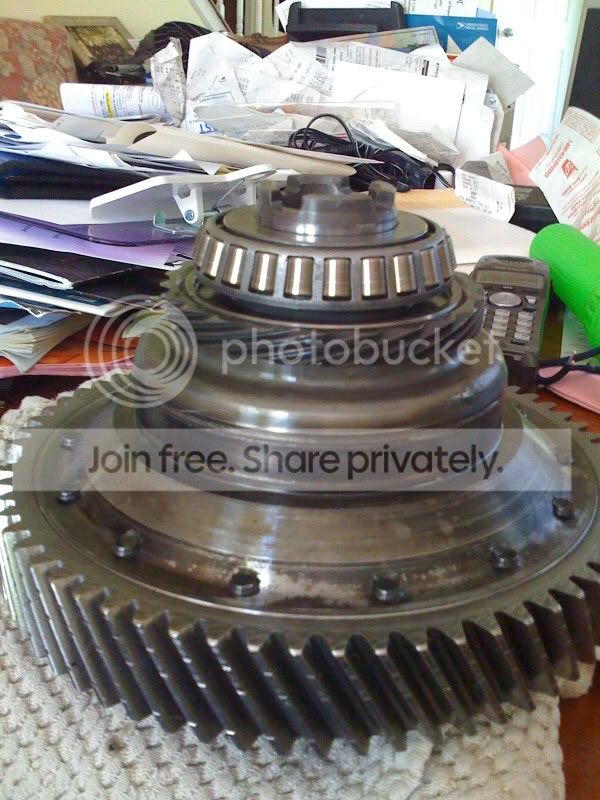

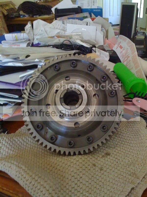

What lsd is this?? Searched
Old Aug 2, 2008 | 10:50 AM
91whiteZCrex's Avatar
Posts: 1,037
From: Daa bears, il, USA
Default What lsd is this?? Searched
ive searched high n low....even ebay goddamnit

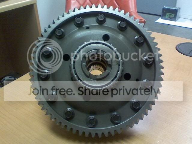

looks like OEM Viscous from a JDM trans...B16 or GSR, but using allen head fasteners instead of hex head
Edit-not 100% the same though :scratch:

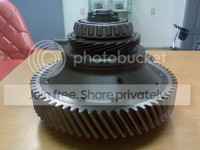

took some pics of a gutted JDM GSR diff I have sitting around
Old Aug 2, 2008 | 06:25 PM
Posts: 1,037
Default Re: What lsd is this?? Searched (Evs-One)
hmm that looks an awful lot like it but i dunno.....its blowing my mind
Old Aug 3, 2008 | 09:10 PM
Gearspeed-Performance's Avatar
Posts: 5,903
From: Rancho Cucamonga, CA
Default Re: What lsd is this?? Searched (91whiteZCrex)
That would be a factory differential my friend. Nobody makes an aftermarket differential with that bolt pattern. It is unique to OEM Honda JDM transmissions equipped with an LSD. There may be slight differences in appearance that vary among generations but, that is about it. Might want to check the clearance on that diff when reinstalling it...Someone did a bad job Or you may want to try and stake the bearing because i looks like it may have been spinning on the bearing spigot as well.
