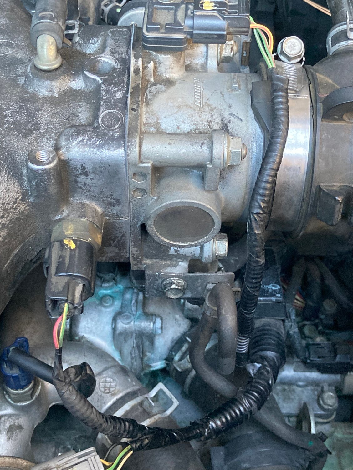

My brothers 07 Pilot is leaking coolant from the plate with the coolant hoses going to it under the throttle body. Does anyone know the name of the gasket under the plate and have a part number for it? Has anyone delt with this before?
Here’s some bad photos
I’m wondering if there’s even a gasket.

There is not a gasket there that Honda lists a part number for. Probably not an item designed to be serviced. Hard to tell for sure but that hose clamp looks suspect. Doesn't look like it is clamping correctly. Should probably remove the throttlebody for a better inspection.

Sorry for the late update. I told my brother to try the hoses and it’s working so far. He got some new clamps on there too. He’s been driving it with no problems.
