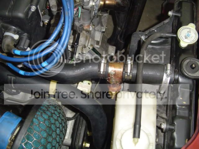

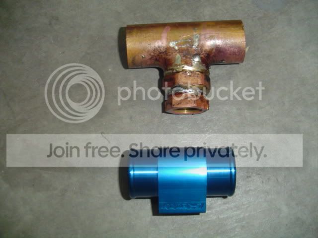

I did the same thing. I made one for a couple of bucks with a copper tee (pardon my soldering skills....... im not a plumber)

here it is installed

diy's are always cool. this place makes em for you.
they have honda sizes (d series) and acura (b series) depending on what you've got.
http://www.nissport.com/catalo...tions
enjoy.

problem is that the autometer uses a 1/2" NPT
and no one makes a piece that uses a 1/2" NPT
and a quck trip to home depot, you can have all the parts you need for $5-10
