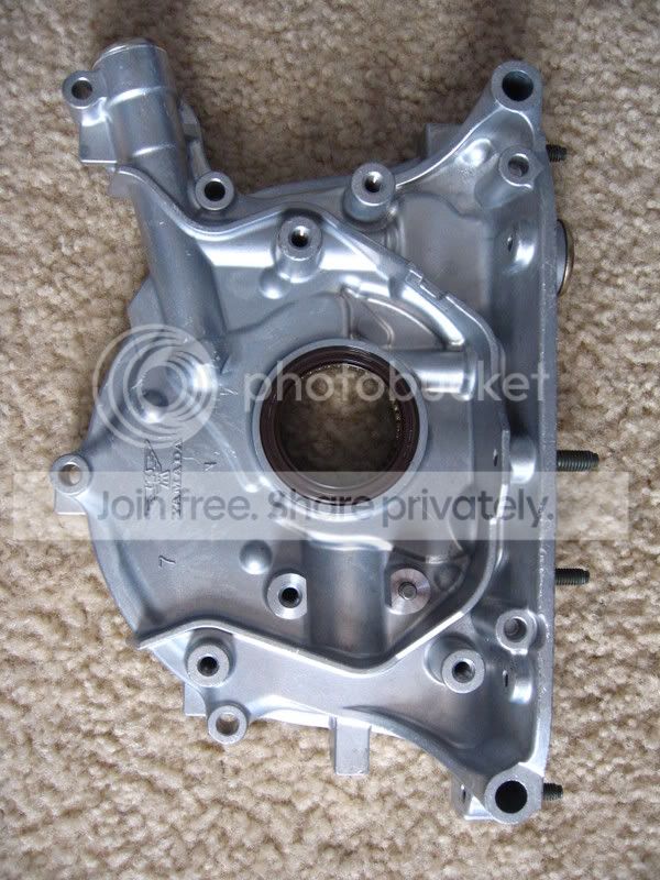

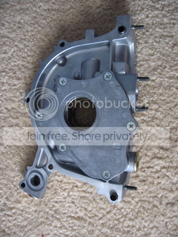

the seal came with my oil pump, do i have to put rtv around it or something?
heres pics of it

your missing a black oring at the left most tip of the pump.
also when you install the pump you need to check for .002 clearence all the way around the crankshaft seal

doesnt leak from the seal, toook the crank pulley off today
most likely is coming from that o ring, dont understand why, i have rtv gasket maker all over that ****

yes you need that o-ring as pisture above in #18
RTV sealant isnt going to cut it PERIOD
you have oil that flow thru that part of the pump
