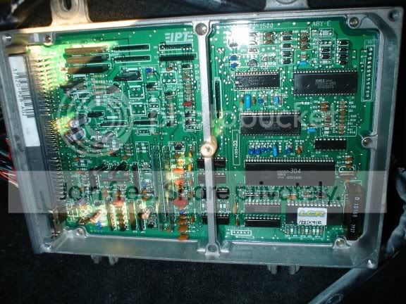

Ok, today i will see what my ecu looks like and post a pic. So, I can end all the wondering.

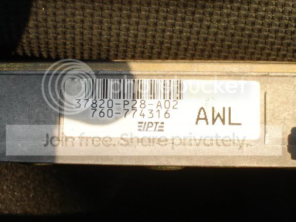

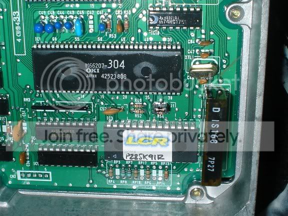

I took some pics and it looks like soldering is required unless i can just flash my ecu..............well i don't know how to do that either:

your going to have desolder and socket that mother

NOOOOOOOOOOOOOOOOOOO! NOT ME i will get some one else to do that ****! I ain't ****** it up! lol! I should be able to hold onto the old chip and reuse it right?
