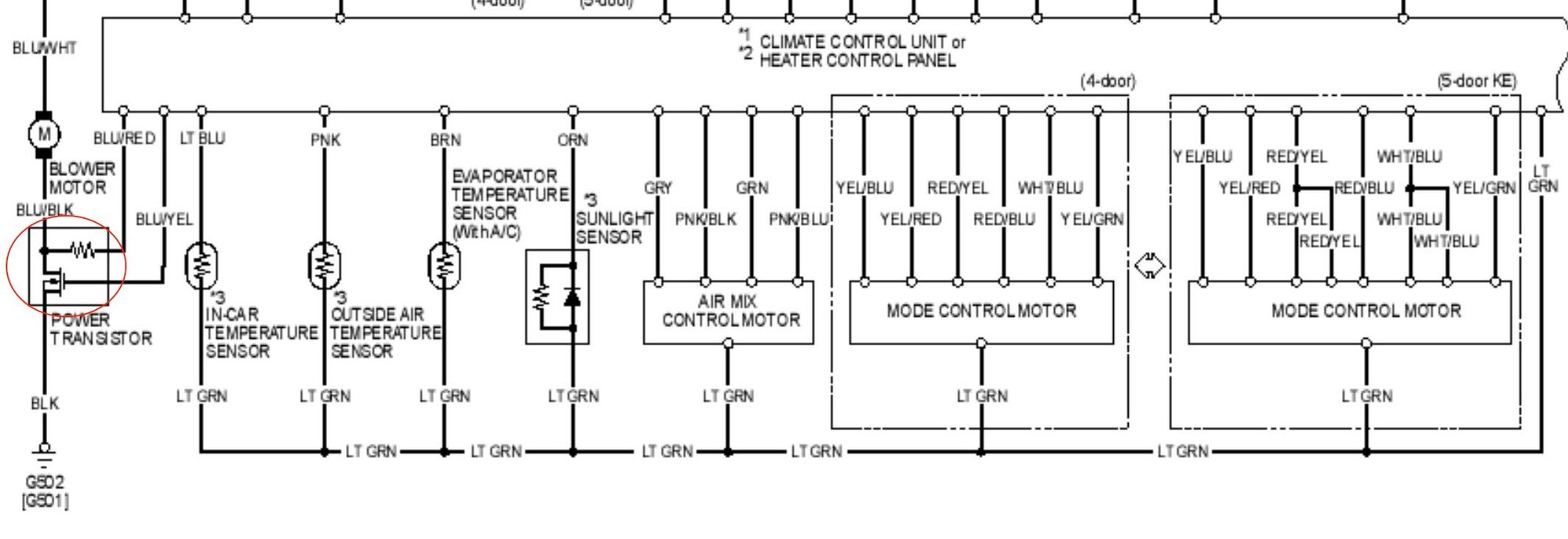

Check the power transistor, which is on the ground circuit.

The "power transistor" is a single unit containing a separate resistor and transistor. See circuit diagram.
Test the Blk ground wire running to G502/G501 and the Blu/Blk, Blu/Red, and Blu/Yel wires for an open.

Did you bypass to the Blk ground wire?

Yes: BLK wire to BLU/WHT wire (https://troubleshootmyvehicle.com/ho...ower-motor-1#3)

Test the three previously mentioned wires for continuity between blower motor and power transistor or between power transistor and heater control unit.

If you can unplug the panel connector without removing the panel itself, then no because the continuity test is done from the connector.
If the three wires test good, then the heater control panel is likely bad.

In that case,OP the ground circuit is very simple and so is the testing.
First make sure everything is plugged in prior to testing(a common mistake)
Make sure the key is in the ON position and the blower motor is in the ON position.
Turn the blower motor to the highest setting(it should run) and measure the voltage at the blu/yellow wire of the blower transistor(pin 1) You should have approx 8-10v.
If you have the correct voltage and no blower operation,the transistor is likely faulty
If you dont have the suggested voltage,the heater control panel is likely at fault.
There are other things we'll look at prior to replacing the control panel or transitor, but lets get the above testing out of the way first.

Ground side switched?
Power resistor was already replaced?
Then by looking at schematics, it seems to be the heater control unit?

I have continuity between the transistor and the motor and the voltage between on Pin #1 of the transistor varies between 0 and 15 mV, depending on the position of the switch (which makes me think that the switch is working).
I also did additional testing: I have 12V on the motor connector (BLUE/WHT) and 3.6 kohm on the ground side (BLK/BLUE). However when I back probe the connector and connect it to the motor, I get 12 V on both sides and an OL between the ground and the BLK/BLUE wire with the key in position II (with the key in position 0, i get 3.6 kohm between ground and the BLK/BLUE wire).
Could it be a short in the motor?

Motor works. Why would here be a short in it?
Motor is ground side switched.
There is a power transistor between the ground side of the motor and the ground.
When testing, hooking up a wire to ground of motor and ground, motor works.
Transistor has been replaced.
So, it is whatever is controlling the transistor that isn't working properly.
It has to be the control unit

But why do I only have an OL between the ground and the BLK/BLUE wire when the motor is connected?
And the voltage on the pin#1 of the transistor varies when I turn the switch, so it looks like it’s working.

That's good and shows no short to ground. Now test end-to-end continuity of the wires.

Looks like I might have an OL on the BLUE/RED wire
