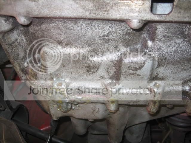

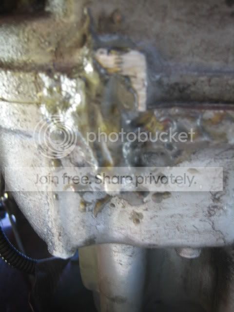

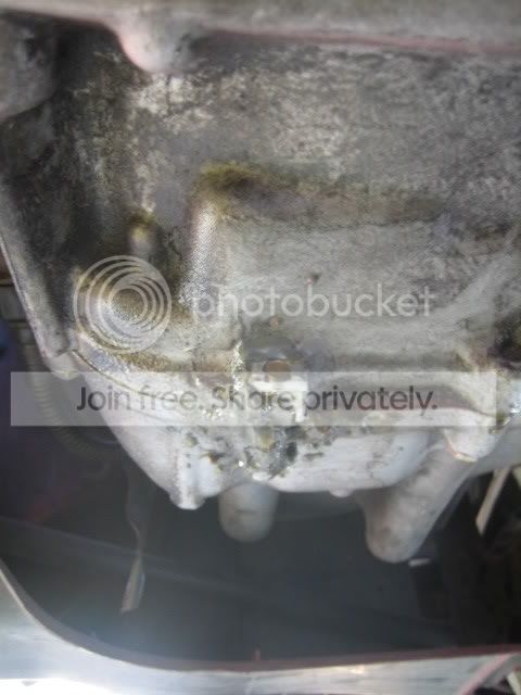

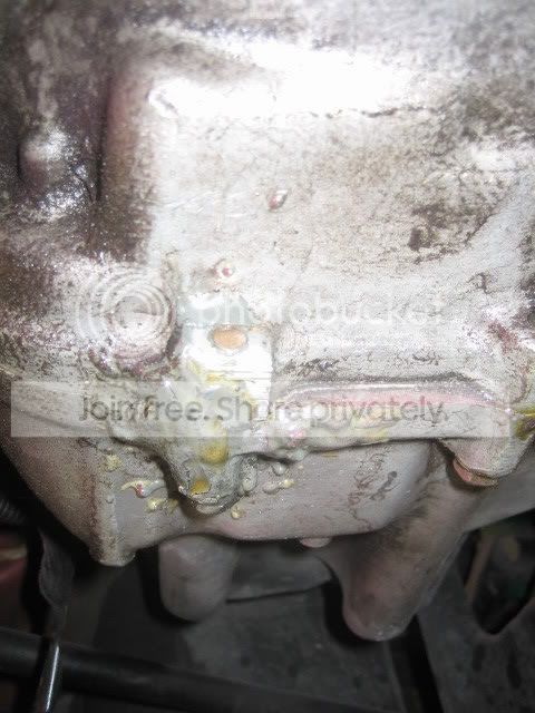

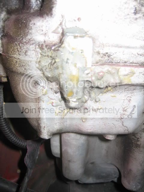

the leak occurs where the case is bolted together near the front. It appears that the previous owner bottomed out somewhere because see fresh metal chips in that area. It looks they tried to fix it with some sort of JB weld. I can see the tranny fluid bead when i am under the car....i can post pics later.

here are some of the leaks from the tranny...looks like JB weld on there..
