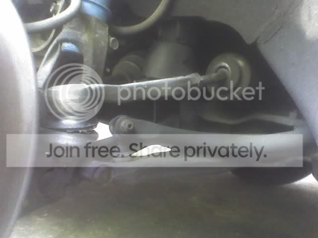

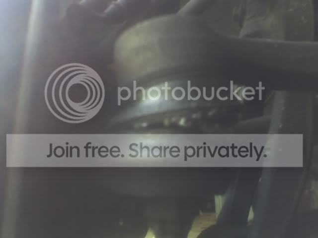

UPDATE:
Car is still making noise and more frequently now. So I decided to finally pull the wheel off and look what I found....
Isnt this the steering hub? And would this be the cause of the noise, thus explaining why when I turn the wheel I can hear it?

That is a tie rod.
Old Apr 24, 2006 | 10:14 AM
AMG's Avatar
AMG
Joined: Aug 2002
Posts: 7,939
From: FL
Default Re: (Jmunk)
<TABLE WIDTH="90%" CELLSPACING=0 CELLPADDING=0 ALIGN=CENTER><TR><TD>Quote, originally posted by Jmunk &raquo;</TD></TR><TR><TD CLASS="quote">That is a tie rod.</TD></TR></TABLE>
Ok. Obviously this is supposed to be seated in the casing right? So is this bad? And could this be causing the strange noise that I am hearing?
Old Apr 24, 2006 | 10:19 AM
spoonek9's Avatar
Posts: 576
From: PA, US
Default Re: (_HondAddicT_)
That is the out tie rod boot. It looks to be ripped, but that isn't anything that would cause a loud noise you are describing.
Old Apr 24, 2006 | 10:46 AM
AMG's Avatar
AMG
Joined: Aug 2002
Posts: 7,939
From: FL
Default Re: (spoonek9)
<TABLE WIDTH="90%" CELLSPACING=0 CELLPADDING=0 ALIGN=CENTER><TR><TD>Quote, originally posted by spoonek9 &raquo;</TD></TR><TR><TD CLASS="quote">That is the out tie rod boot. It looks to be ripped, but that isn't anything that would cause a loud noise you are describing. </TD></TR></TABLE>
Ok Thanks Man. Other than that I really couldnt find out whats cause the noise. I do know that it is not a rubbing noise, but more of an air pressure sort of noise.

It looks like that boot to your rack is also ripped. Check the play in that tie rod end and get it replaced before worrying about anything else.
