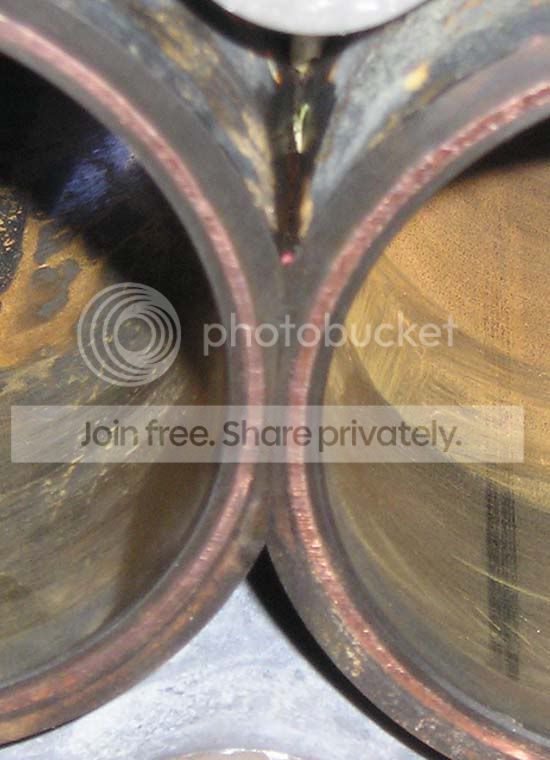

could someone tell me if these are stock sleeves? or if there is a possibility that they are darton:
thanks

Picture doesn't work, but it's an easy question to answer anyway.
Stock "sleeves" are not individual sleeves at all. All four cylinders are fused together as one piece. Aftermarket sleeves, however, are individual per cylinder. If you want to know whether or not you have aftermarket sleeves, just look (closely) where any two cylinder walls touch - if you can see a line down the middle where they touch, you have aftermarkets.
Make sense? Stock sleeves = one piece. Aftermarkets = 4 pieces.

ah, didnt know that about the stock ones.
Anyway, earl helped me out to identify what mine are.

and what are they?
Old Aug 17, 2006 | 08:17 AM
MAFDARK's Avatar
Posts: 2,328
From: NY
darton sleeves put in by benson.
