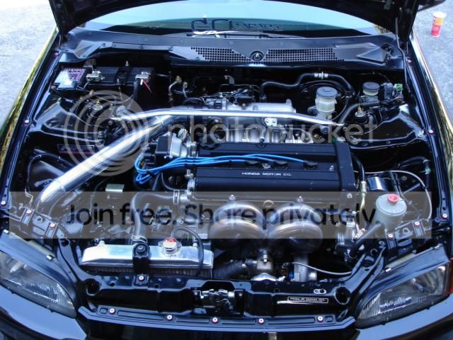

Nice clean engine bay there^
If a motor is totally assembled, it really doesn't hurt it to sit for several years, and then be turned over again. People buy engines from junkyards or Japan which may have sat a decade. Change the oil, pull the fuel pump/EFI fuse and get some oil pressure and then fire it up.
