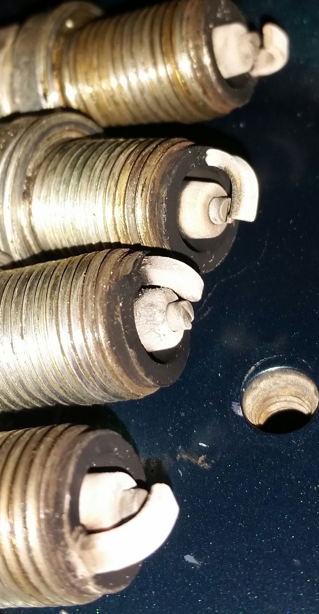

Hey I've got about 1200 miles on my rebuilt b18c gsr forged and turboed with upgraded fuel pump and 1k injectors and I checked my spark plugs and one was kinda melted is that running lean?

Seems like u are running lean or might not be right plugs. Just my opinion

Could be your tune.

See those specs from the flash? Thats detonation
Too much timing
Too lean
**** gas
Or wrong heat range plug
It melted because theres too much heat in that cylinder
Look into getting the injectors cleaned
